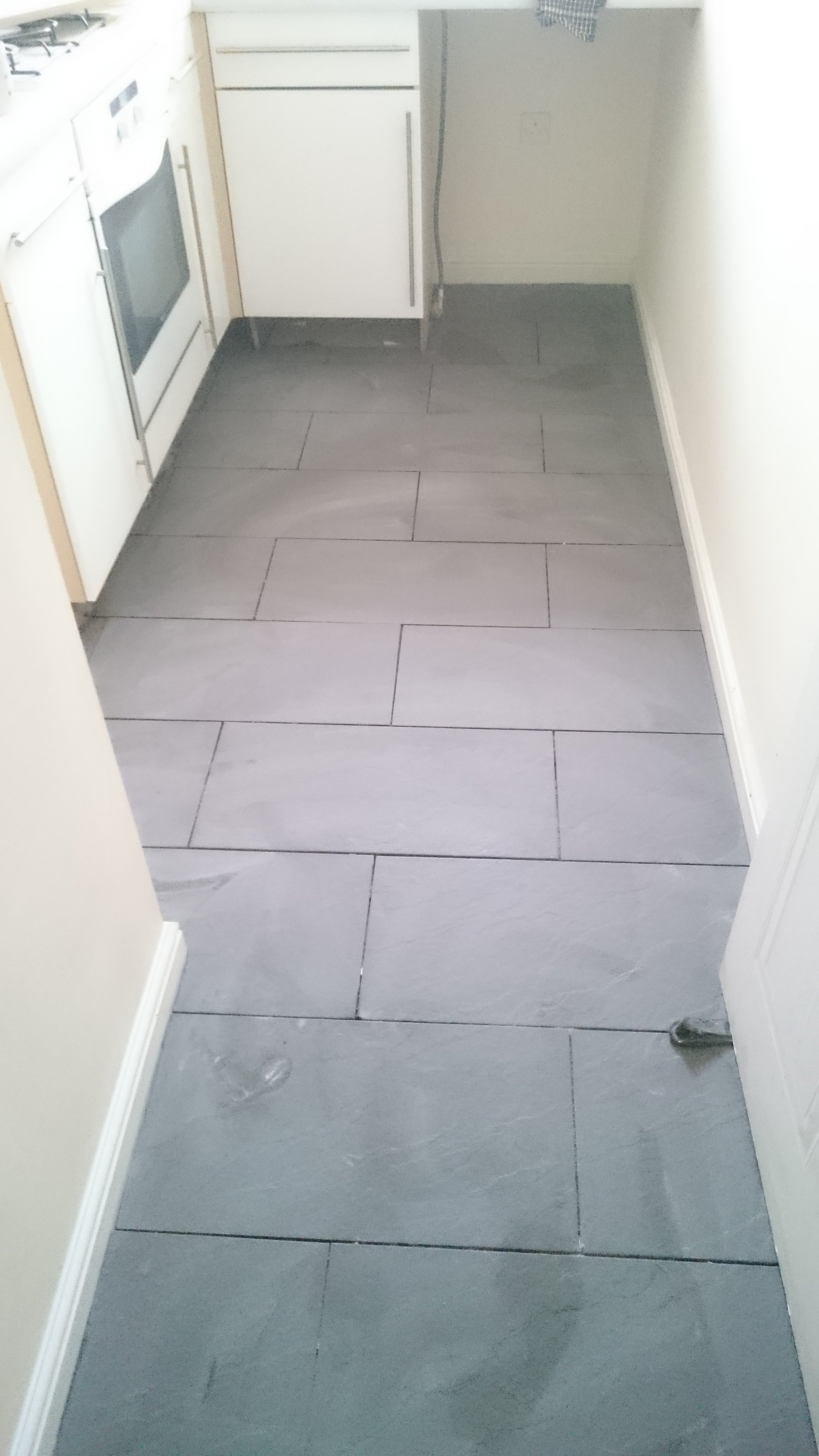

I wanted to get both my bathroom floor and my kitchen floor tiled in my small flat. Both floors were concrete base. For the floors i thought it was best to get a professional to do it. I found a tiler on checkatrade with very good reviews, albeit for a variety of different jobs, plumbing etc too. He came round and quoted me £200 plus materials for both floors. That sounded good so i booked him in. I already had the 60x30 porcelain tiles purchased ready. He said he was a plumber too so would remove the toilet and tile under etc.

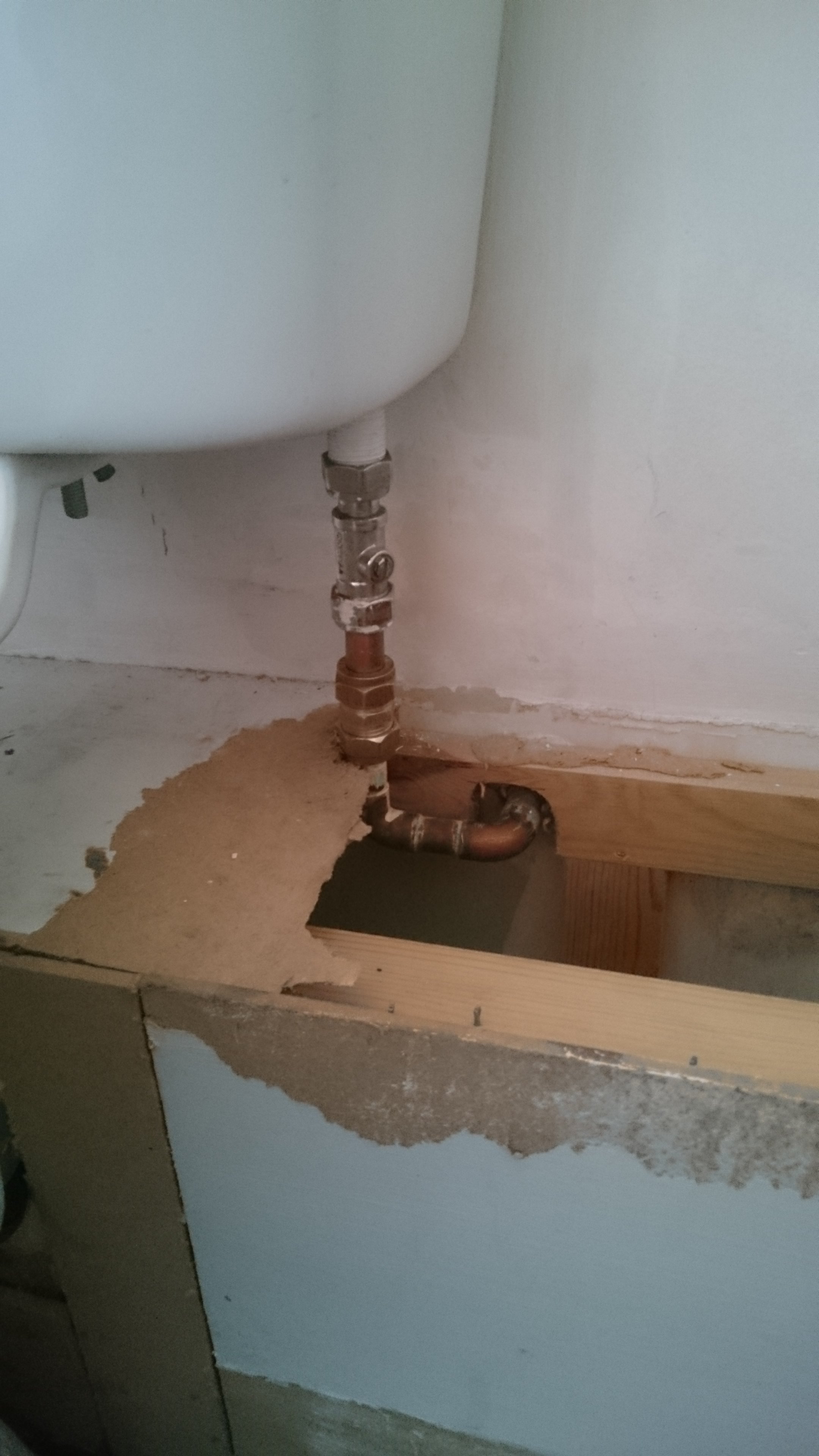

The day of the job came and i left him to it. I have attached photos of the bathroom before and after the first day. The dust was ridiculous. He left all his tools, the only cutter i could see was a grinder. Is that normal to use for porcelain tiles?
So the next day he came and finished the job and grouted it all up and put the toilet back on. The toilet was not drilled back onto the tiles, he said just put Silicon around the base and itll be fine, is that ok to do? My guess is he didnt want to drill the tiles but not sure the norm?
A few days later i noticed the grout cracking in the kitchen and falling out. When i inspected the tiles more closely, the tiles affected sounded hollow when i tapped them, is that normal? Quite a few are hollow sounding.
By this point he was already paid and gone, messaged me a few times to ask me to leave checkatrade feedback, i haven't yet. To be honest im getting bad vibes about this work and dont really want him back. Whats your thoughts on it? I can take more pics to show you.

Ill see your expert take on it and decide where to go from there, or am i worrying too much? Slightly worried about the plumbing too, he did say he had a bit of a leak with it. Thanks guys

The work is all of an exceptionally poor quality. Sounds like he spot fixed the tiles, he has tiled onto chipboard, no attention to detail, uneven levels on the tiles, messy work and untidy plumbing. Using just Silicon on the toilet is fine so long as it is done correctly. Take it up with Checkatrade ....... they have a mediation service.

Yes hammer on the edge and toilet directly in bath, luckilly no damage.
More i think about the job, the more annoyed its making me. Hes definitely not stepping foot in my flat again. I cant see how this job can be 'put right' without starting again.
