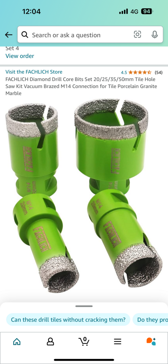

Think it depends which you get tbh. I use these dry on porcelain and once they wear a bit i just use a damp sponge
