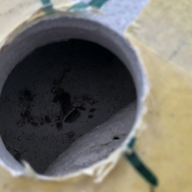

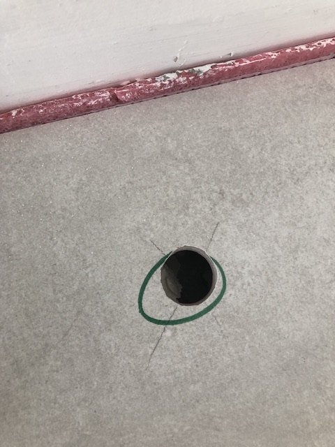

I decided to drill a 1.25” inspection hole in 3 tiles - 2 will be under a kitchen island and one under a corner base unit. Each hole was drilled over an identified hollow spot and revealed … no adhesive
underneath. Just a 25mm+ deep void.

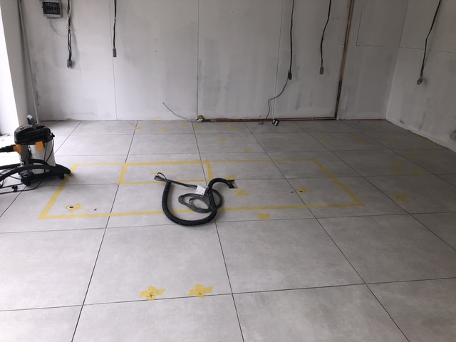

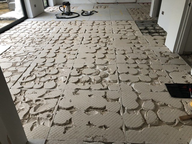

You are spot on. I’ve replied to your other reply, good suggestion of yours btw,. The whole floor is coming up now.

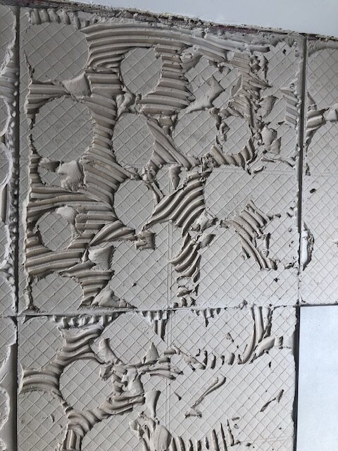

Its the kitchen but you are right. I did wonder if the thin back buttering stuck to the dabs but came away from the tile.
I saw the video link in one of your posts about trowelling and back buttering. Its very informative. Our guy has done everything the video says not to.. even down to swirling the notched trowel & then dabbing the tile in places.
