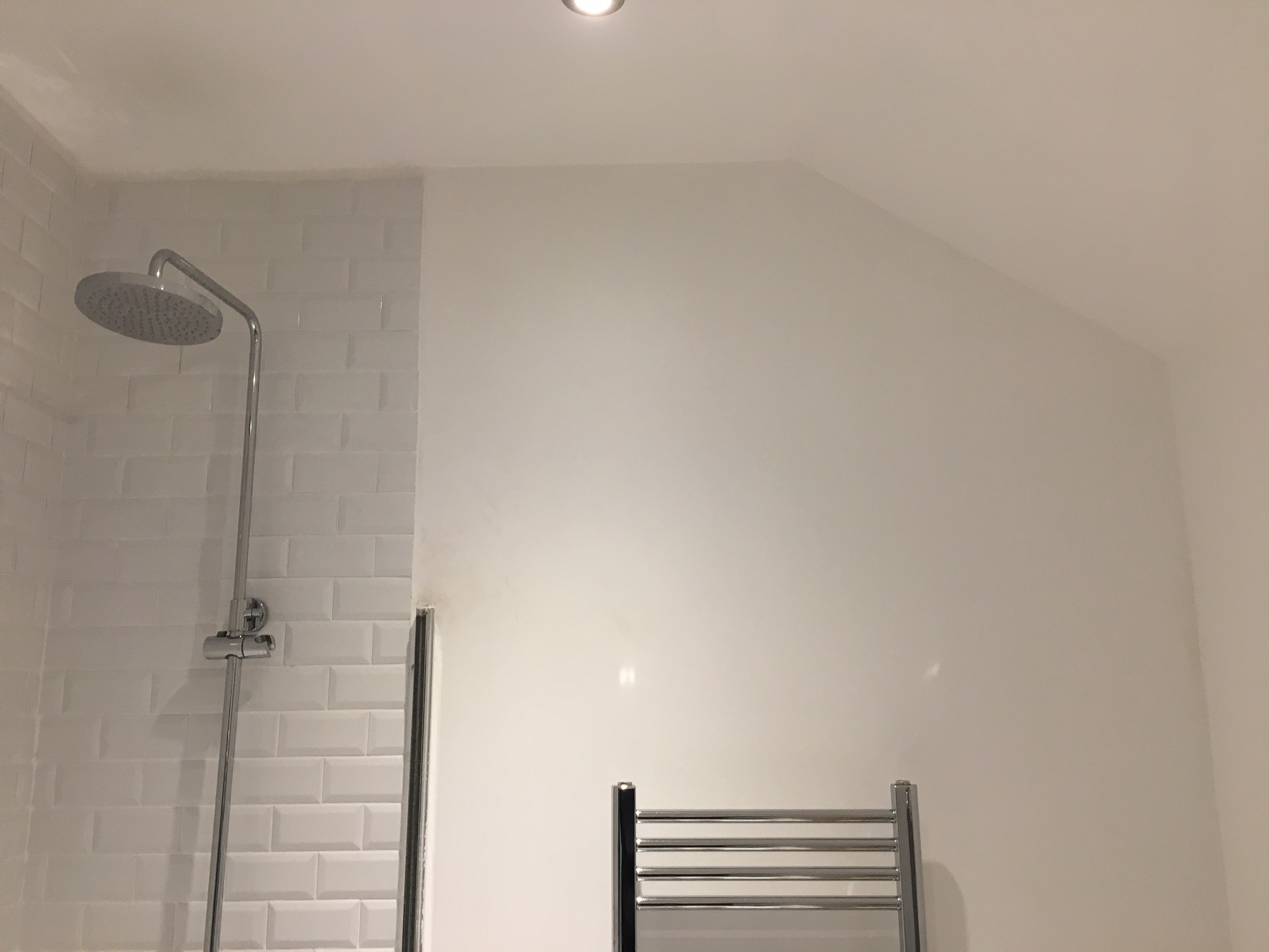

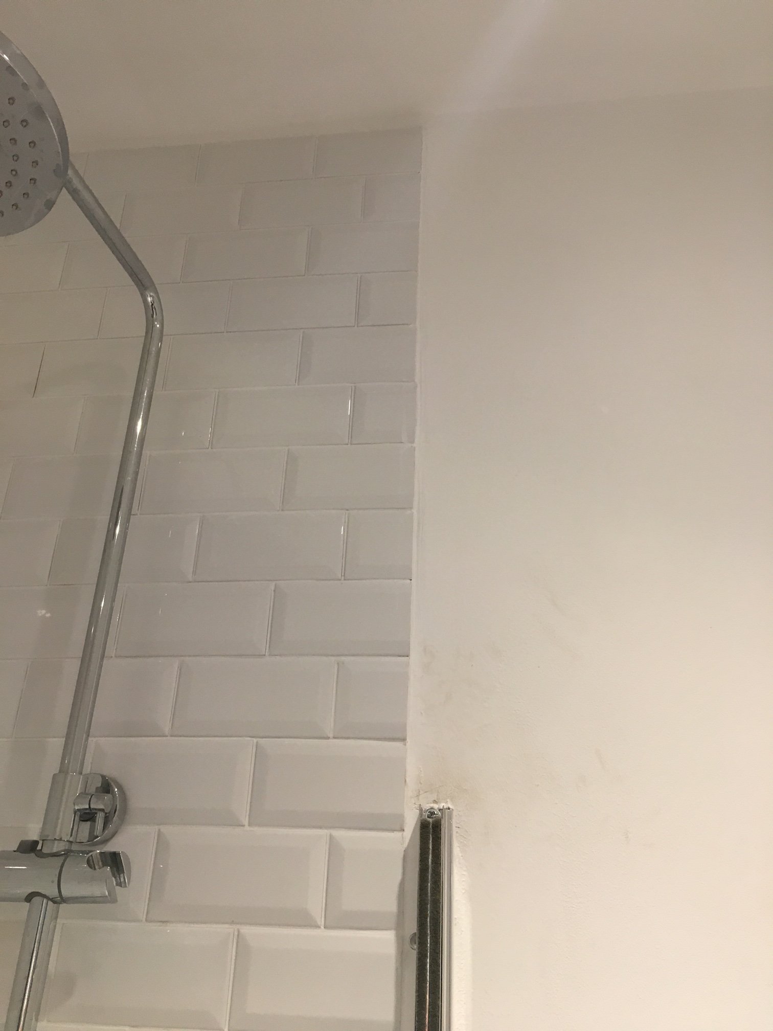

I made a mess with my bathroom tiles a while back and I want to put them right.
Photos tell it all pretty much. What are my options on making a border here that will not look bodged and out of place ?
I have enough extra tiles to continue to the right end of the wall but that wont achieve anything. I really want a solution inline with the glass screen bracket.
any opinions much appreciated
Blunt Tool
View attachment 88801 View attachment 88802
Hi welcome to the forum :) I would suggest taking off the shower screen bracket (it should be fixed to the tiles with screws and Silicon) then if it's an easy fix you are after, install a line of same tiles but on the vertical, one vertical will line up with two horizontals and install a white plastic or chrome trim to give a finish edge. Hope that makes sense!
5,094
1,323
I'd also go over it with more grout perhaps. Make those joints look neater.
Then just move the thingy-me-bob over, or use a metal tile trim perhaps. www.protilertools.co.uk have loads of options for that kinda thing.
