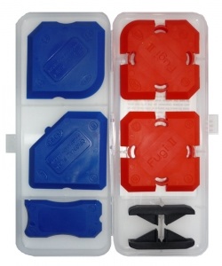

then using a fugi tool, again working from the corner apply good pressure and drag the tool along the bead.

4-Using Fugi tool at 90' angle, tool the bead to required size

I use the c-folded towels to wipe down the fugi tool as I go, and the cloth with the isopropanol on to keep the tool (and my fingers) free of Silicon at the end of each bead.
