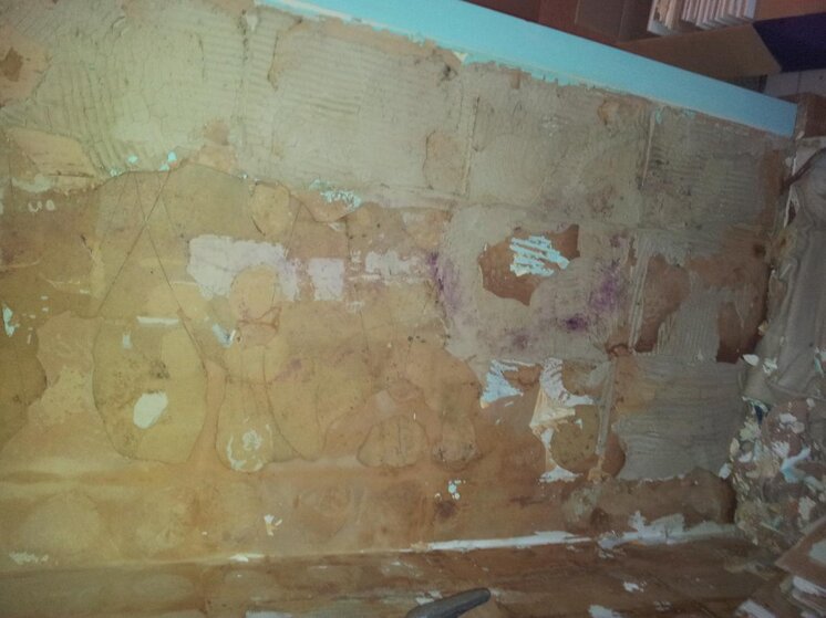

Had to rip out a shower cubicle then re-tile it, got as far as the rip out.

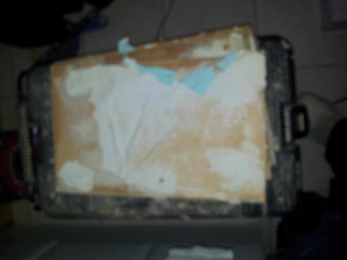

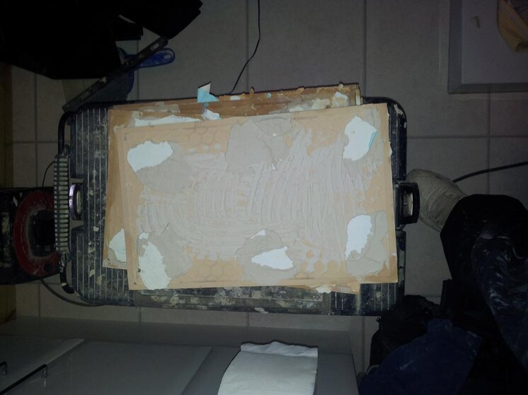

I took every tile off by hand after i had pulled the trim off sides and top by just pulling it.
tiling was dot and dabbed on to paint plus really bad grouting,think the only thing holding them up was the grout. the only tile to break was one where the shower cubicle was screwed to the wall. As soon as i got 2-3 tiles off the musty smell hit me and i knew i was having the rest of the day off. 30 mins to take down all tiles 4.5mtrs and clean off old adhesive and paint. Cant do anything for 3 days to let walls dry.
Its block walls with a plaster skim so hoping it should dry out,have been checking it every day and it is drying quite well.
Anybody think the plaster will be ruined or once dried, brushed down,cleaned and primed and i always use powdered addy should be ok to tile.
ive come across 3 jobs now that have been ruined by dot and dabbing and 2 of those was travertine.
got pics but cant upload them or i upload them and they dont appear.

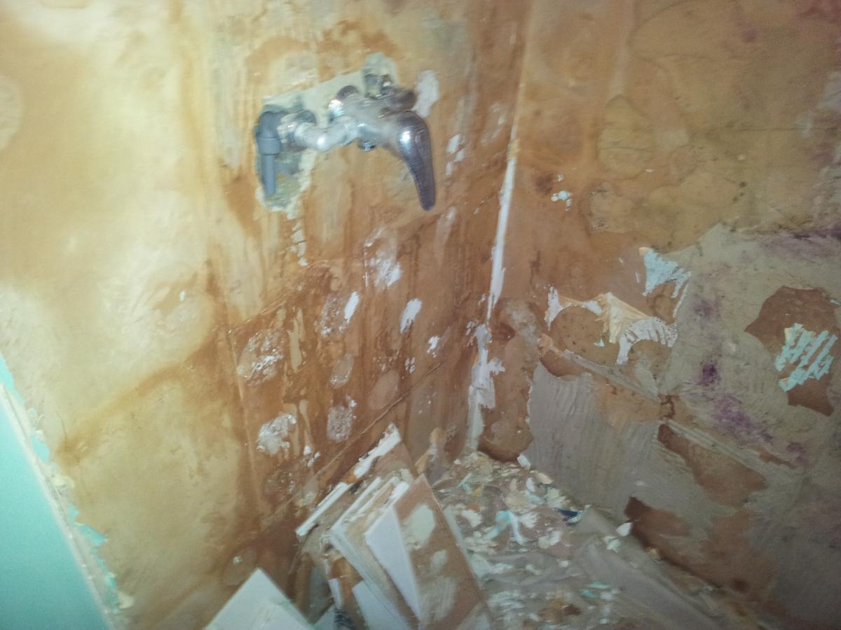

Where the bad plaster is there is a hole where the shower pipes come up and it is only a 2mm skim of plaster onto the blocks,might be different lower down,i will check.
The other wall looks like they plastered around where the tiles are and then either ran out of plaster or couldnt be bothered to mix up some more but left the center of the wall as it was being tiled.
The shower cubicle is in a corner of the room so over boarding probably isnt possible.
Its only a days tiling so i dont mind waiting it if gets replastered just most of a days work lost due to somebody else's bad work.
2011-11-29 08.53.39.jpg 2011-11-29 08.53.48.jpg 2011-11-29 09.10.00.jpg 2011-11-29 09.10.08.jpg
The wall where the plaster is patchy is the old outside wall which was rendered the other wall with the shower on is a new build with block work as the 3 walls are all outside walls. The bit between the pipes is a filler of some kind but if you look closely you'll see the breeze block(??) is very near to the edge.
