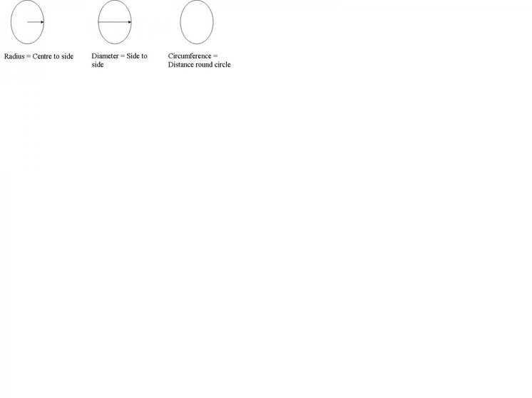

As Im not working today I though I would make a quick how to for any newbies or anyone who may not know what formula to use for calcuting tile quanties for design works which include tiling circular areas. I know to some, this may seem basic but, I have heard this type of question many times so hopefully some of you will find this to be usefull.
Radius = centre to outside of circle
Diameter = distance from one side to the opposite side of circle
Circumference = distance around the circle
Whenever calculating area for circular spaces on the floor, wall or even pillars we must do so using the radius, Diameter and circumference. With these measurements we can calculate areas by adding Pi (3.14159) into the formula.
For example to calculate the are of a circle to get your tile requirements you first of need to measure the radius (as shown in the pics) you then multiply the radius by radius, you then multiply this sum by pi(3.14159) and this will give you the area of the circle. Here is an example/ demo;
