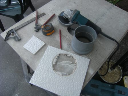

Tools used.
tape measure/pencil/parrot nibblers/grindette/diamond blade/safety glasses/square and a piece of waste pipe which i always keep in the van..

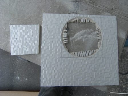

How to do. Firstly mark the centre of your pipe onto the tile, then measure and mark equall distance either side off centre lines to find the outside diameter of your hole in this case it was 135mm as it was a joiner collett and then allow en extra 2mm for ease. Then draw a square and then put pipe in the middle and draw around it.

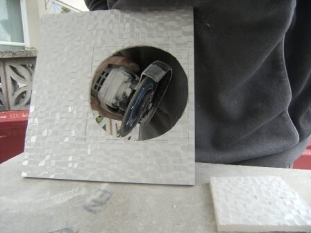

Then take your grindette and cut a square in the middle off the circle removing as much waste material as possible
Now cut around the circle with the grindette to about 2mm depth and then cut lines all the way around it like a combe affect starting from the middle and cutting towards the circle line.

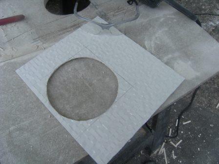

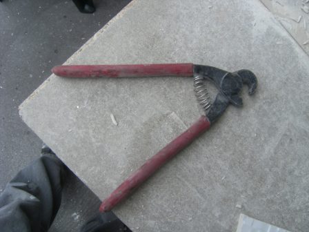

Once all the way around you can now tap the slithers sideways and they will break off and you can then use your parrott nibblers to remove the rest off the waste.
You can then use your grindette to fettle and tidy up any little bits needed by inserting the grindette threw the back off the tile.
And hey presto you have a neat tidy job. :thumbsup:
And this took me about 10 mins including my david bailey shots :smilewinkgrin:
