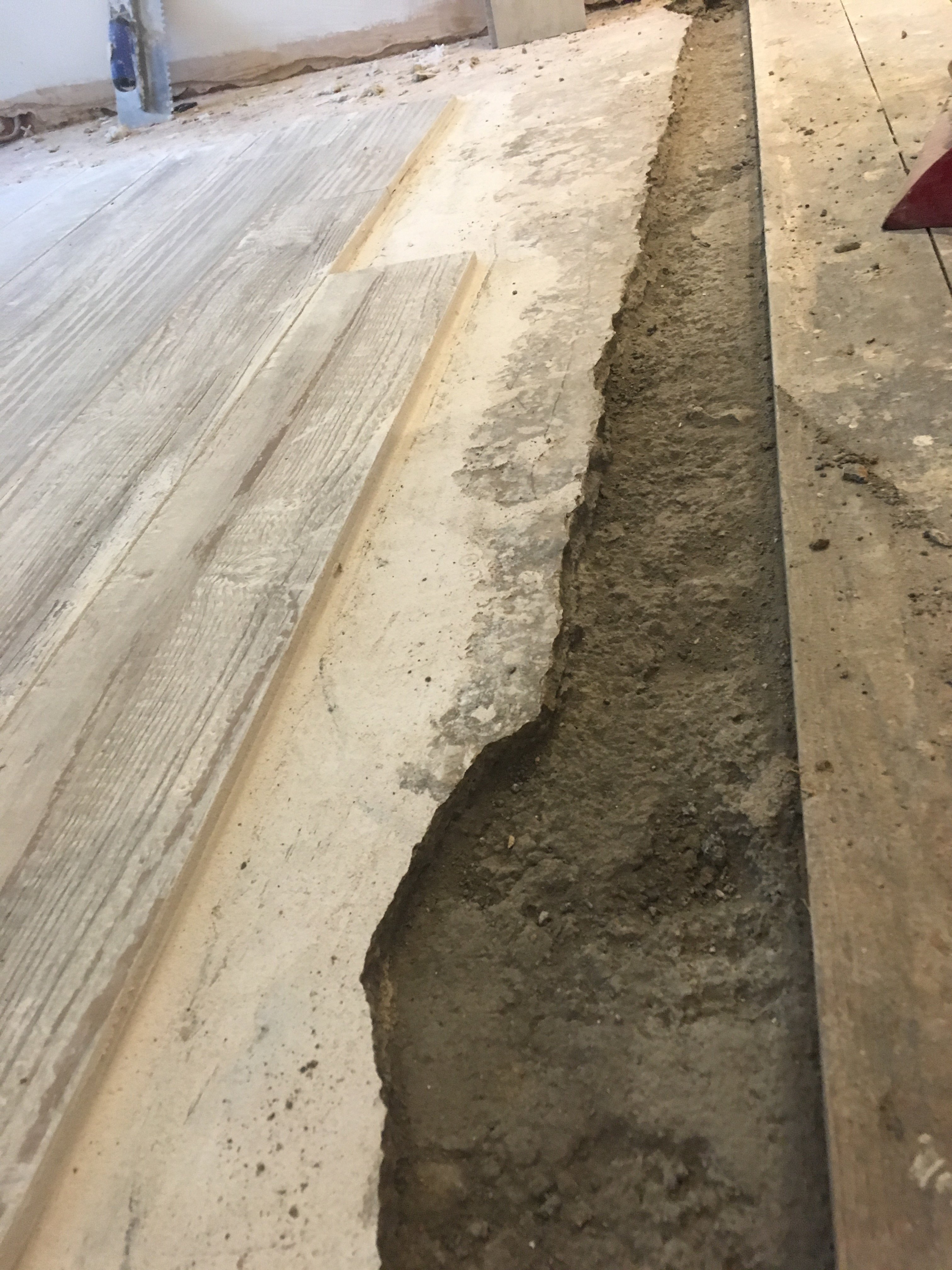

I'm getting to the end of the room and there is a gap in the floor where I used to have a wall,
I have a choice of ra ither putting a floor board in the hole and then tiling to the floor board, or fill the gap in the floor and tile to the existing floor board.
Few questions....
Can I get a transition strip about 2.3m for full length of room? Any stores local to s.london?
What is the best thing to fill Gap with? I have sharp sand and cement, could I use this and tile 2 days later?
Cheers!!
Dumbo
Do not use sharp sand and cement it will not be ready . Either use a thick bed levelling compound . Their are a few around or use ardex a35 rapid drying cement and sand as this is ready to tile easily the next day . Most tile shops or flooring shops should be able to do you a transition strip to 2.5 metres long .
