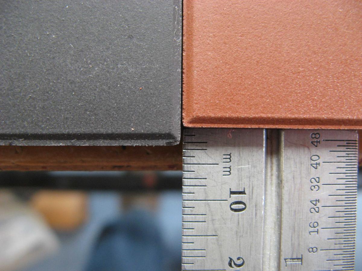

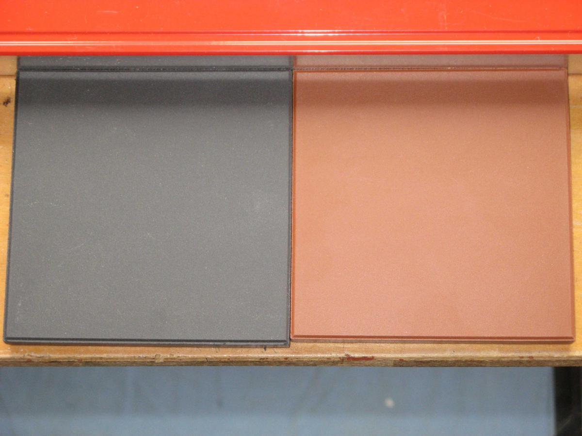

Hi All,
I am proposing to tile my porch in a checkerboard pattern with red and black Winckleman 4x4 Quarry tiles purchased from Tile Giant....the problem I'm finding is that no 2 tiles seem to have the same dimensions, especially between the reds and blacks they vary by 1 to 2mm have some sides that are out of square and slightly curved on some too!!! I tried a dry run with spacers and it was terrible!....is it common with these sort of tiles to be like this or is it possible that these are seconds?? I am toying with trimming all the black tiles slightly to make life easier? and or set them out by eye.....there website talks about the quality of their tiles and shows them in really complicated geometric patterns, but I really don't see how that would be possible with the tiles I've got! your opinions would be most welcome....

November uploads + 011.jpg I've always found the Winklemans to be very good tiles so I'd check the dates on the production and see how old the stock is. 2mm is too much to accept.

Update....Tile Giant have been very helpful despite the supplier saying they are within the standards specification and are ordering another batch of tiles to see what size they come in at and then try and get the best match in sizes between the new batch and the existing ones I have etc.....while I'm here what trowel notch size do you think I should use for these 100mmx100mm 8mm thick tiles on a self levelled floor?

Great news with Tile Giant. It is a shame there are tolerances so great with things like this but it will be down to the tiles being made on different machines etc.

I fail to see how the manufacturer can claim they are within tolerance as they can clearly get all the black one size and the red all the same size too ...but not the same as each other....Stupid !
