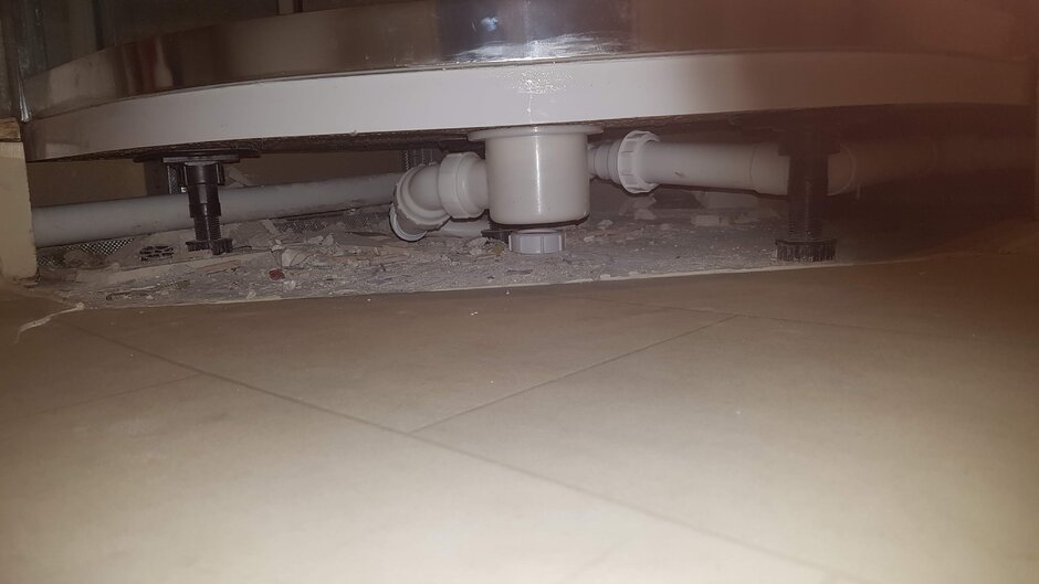

Having a nightmare with a new quadrant shower that was been fitted (not yet completed due to some cosmetic touch ups and the plastic cover at the front to hide the pipework being on order) and was hoping for some advice.
The shower tray has seemingly been fitted too far back on one side (the right) so the enclosure won't fit properly and it sticks out over the edge of the tray, and I'm aware it should be 10mm inside the tray. I'm naturally going to get onto the fitter to sort it but I want to be as knowledgeable as I can about the situation first.
I've noticed that on the left side, the tray is resting against wall studs. The plastic covering the pipework at the front hasn't been installed yet which is handy as I can investigate more easily. Basically on the left side I can put my hand under the tray and behind it. I can run my hand down the back of the tray and there is what I assume is plasterboard flush to the edge of the tray (i.e. I can run my hand down the board and to the tray in a level motion), i.e. it seems to be resting on top of the tray and doesn't go behind or below.
On the right side however, it's different. There are no studs on this side so the tray seems to have been fitted right up against the wall (whatever material it is). It looks like there is some plasterboard in front of that which again is resting on top of the tray. On this side I CAN'T touch the back of the tray (I assume because it's not against any studs so it's totally against a flat surface). Because the tray goes further behind the plasterboard on this side, the enclosure can't find properly as the length of tray sticking out from the tiles is smaller than the enclosure's minimum adjustment.
I was just wondering if anyone can advise how this should be remedied. Is it a case of ripping it all out and starting again, with the right side of the tray not pushed as far back this time? Also, is it ok for the board to be resting on top of the tray? I assume it can't go to the floor because of the pipework beneath on the right side...
I'm not sure really how it was done before but I had a pentagon tray and enclosure which leaked ever since I moved into the apartment so I lost patience.
I've included some pics of it all (including some pics of how it looked when they ripped it all out) which hopefully help.. one of them shows a hole in the plasterboard on the right side showing the grey plasterboard which I think goes behind the shower tiles... just to show that the sandy-coloured material on the right side which the shower tray is against isn't the material which the tiles are on.
Any thoughts greatly appreciated :)

It looks like the tray is recessed into the wall too far , thus not leaving enough room for the screen to fit properly after tiling.
Yeah agreed. Is it ok though to sit the plasterboard on top of the tray as has been done here? Or should that only be done with those trays that have the upstand lip?
Its not no. Plasterboard should be fully down And under the recently new BS5385 standards, the walls should be tanked/waterproofed.
Hmm I have no idea what he should do then :/ the existing plasterboard can't go to the ground because of pipework at the bottom.
What a nightmare.
The main issue is the tray is too far back.

I understand, I just mean that if tray is brought forward, what will it be sealed to? Sorry if I'm not understanding.
I know what you mean but at the end of the day , the installer needs to correct his mistake. What has been done is incorrect.
