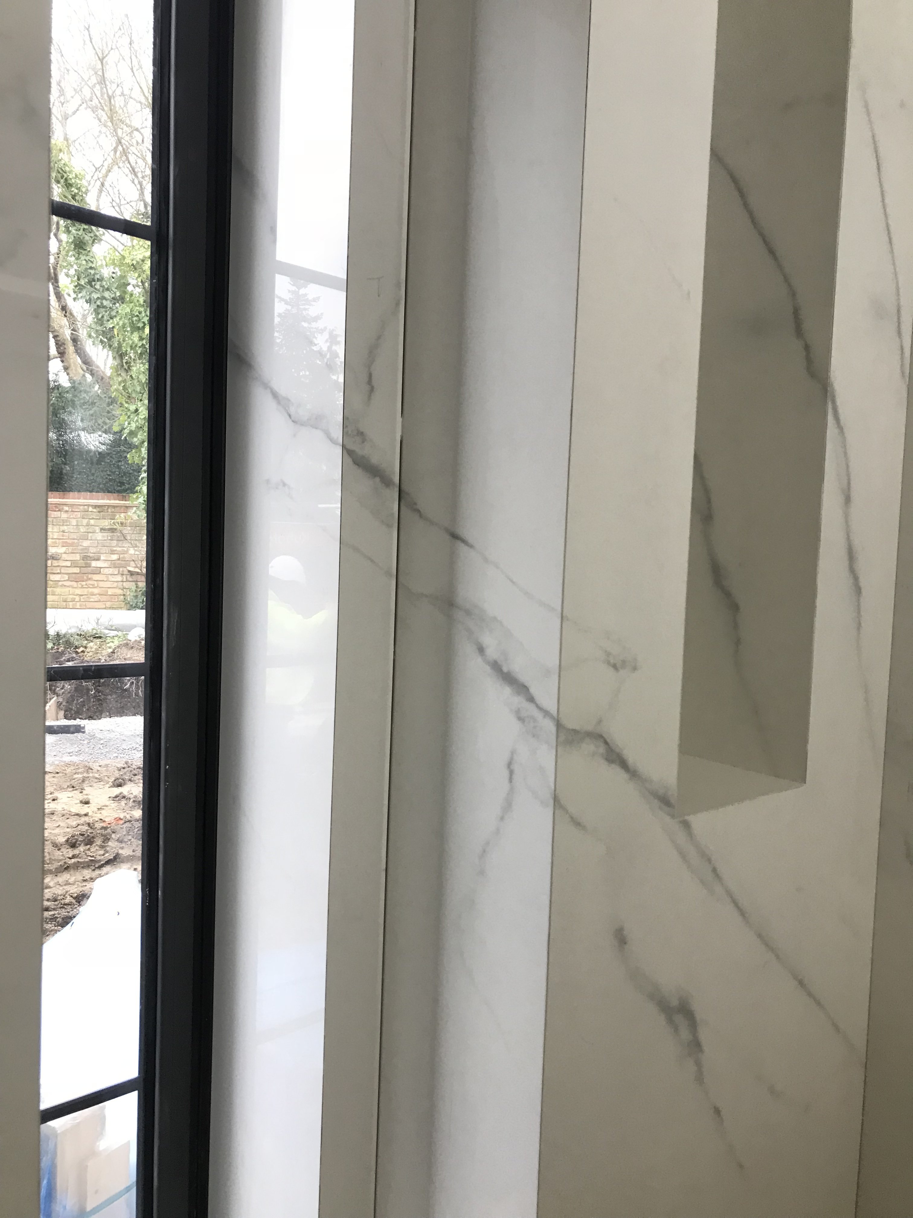

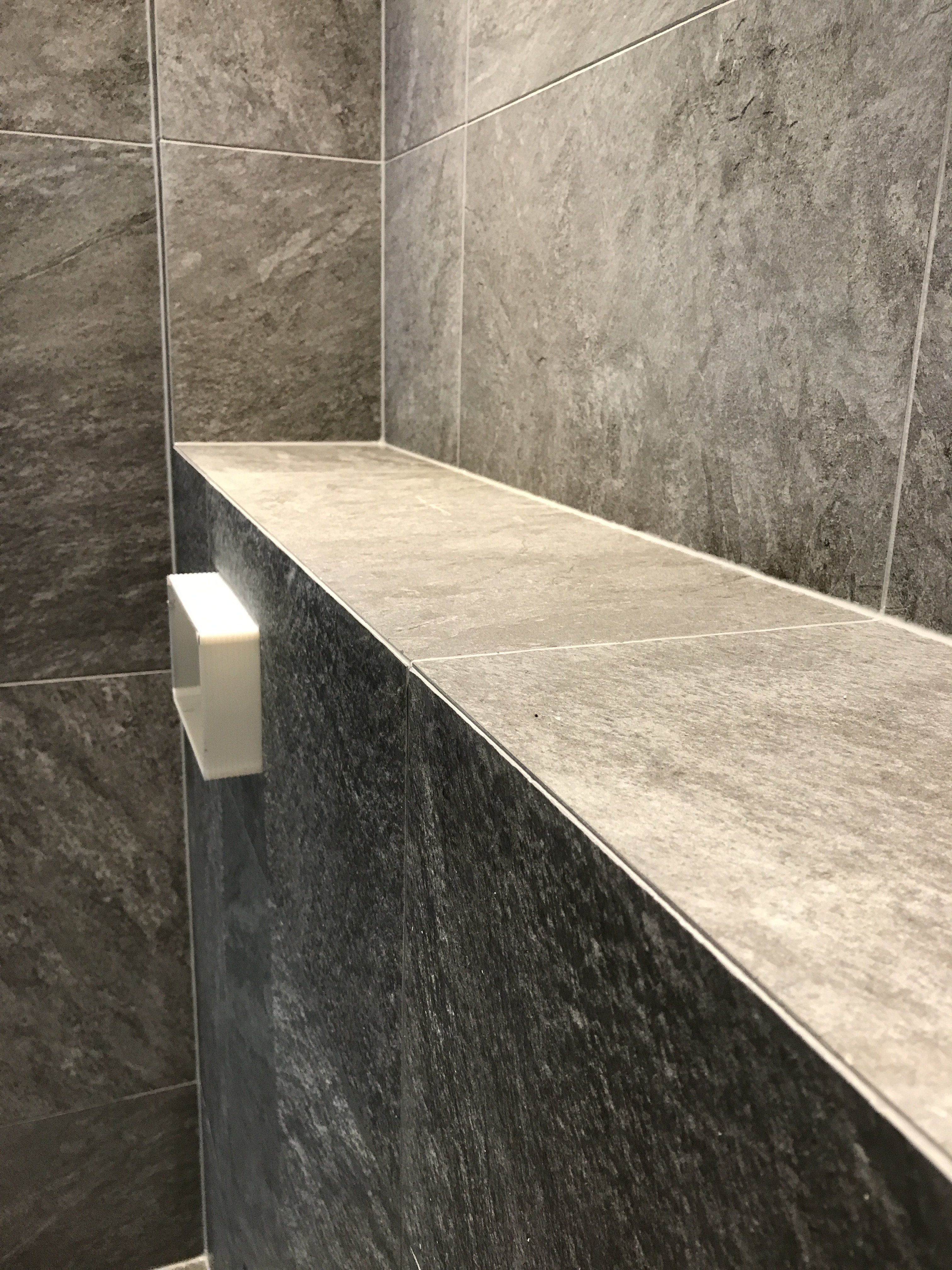

I was just wondering if anyone has the sigma jolly edge, or used one?
I brought one around a year ago. It worked very well for about 7 mitres on a 60/60 porcelain tile.
All of a sudden it started to run off the mitre edge leaving it thick. I’ve read the set up instructions and have it set right. But can’t get it to work as it did.
I’ll try upload some pics of the mitres it did to begin with, but am getting errors.

Here are some pics

Better off just learning how to do it with a grinder diamond blade and a polishing wheel.
You mean to tell me you don’t use a 3 meter long wet cutter? :eek:
I don’t mind doing it by hand, but that machine to begin with I was happy with. It only managed to do 7 tiles. The rest I did by hand.
Just please do not zoom in haha

No, it uses a diamond blade. The jolly angle, or bevel use the polishing discs.

If it uses a diamond blade, first thing that comes to mind is to use a dressing stone first and check that blade is not bending as you mitre.
When mitring blades tend to be pushed outward on a fixed machine. That doesn’t happen so much when done by hand.
Can you adjust the rake on the blade?
Adjust it so that it ‘toes in’ on the leading edge, it’s leas likely to bend that way.
And of course you could always just try going slower, it’s our impatience that often leads to issues.
If you try any of the above, please come back and tell us how you get on.

Yes it has to be set up toes in using a metal ruler. There are measurements on the instructions on what the gap should be on the front and back of the machine.
I’ll dig it out the shed an try doing a video of it, with what you have said.
