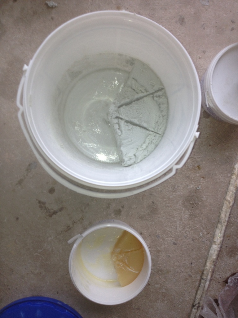

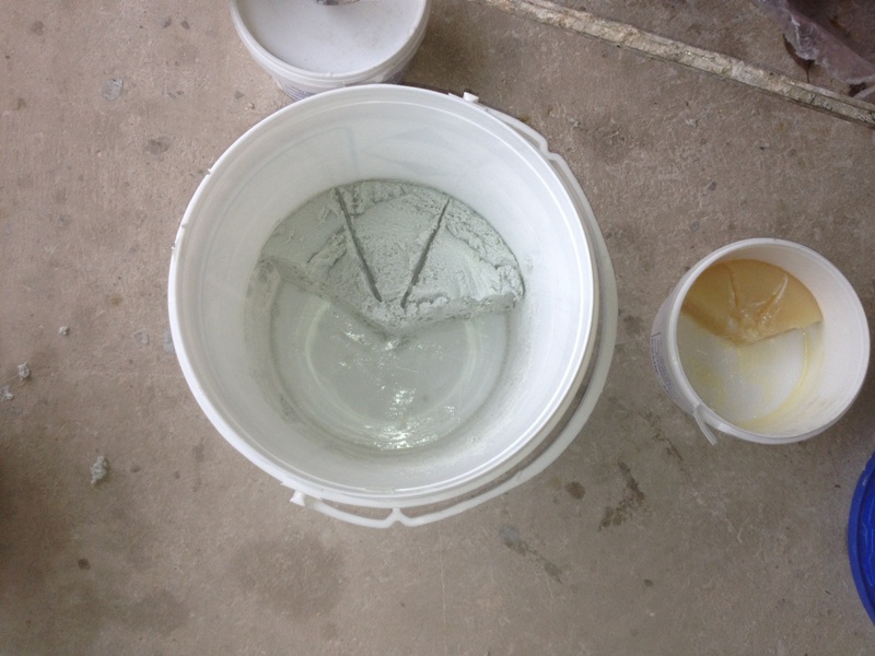

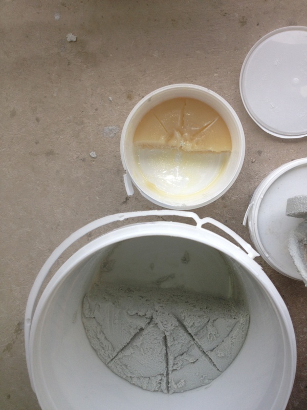

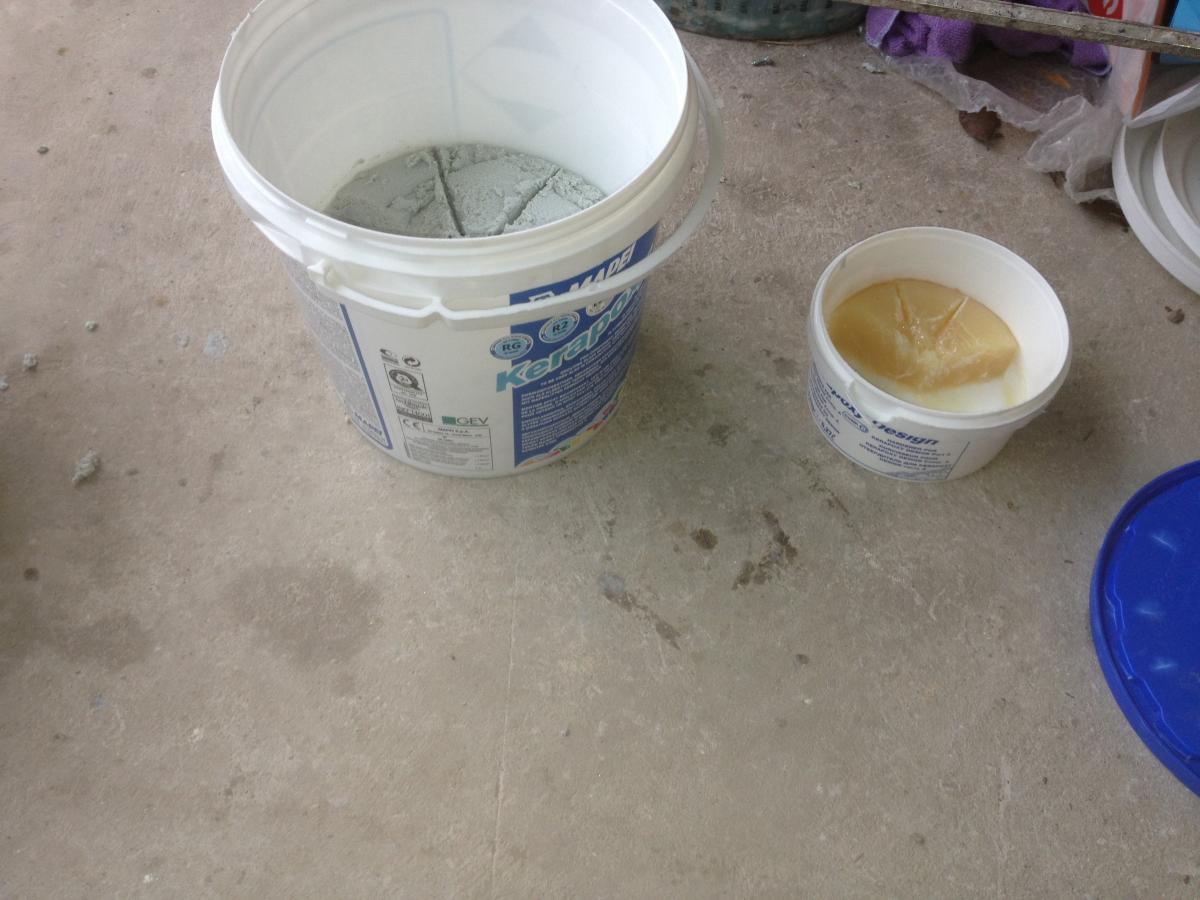

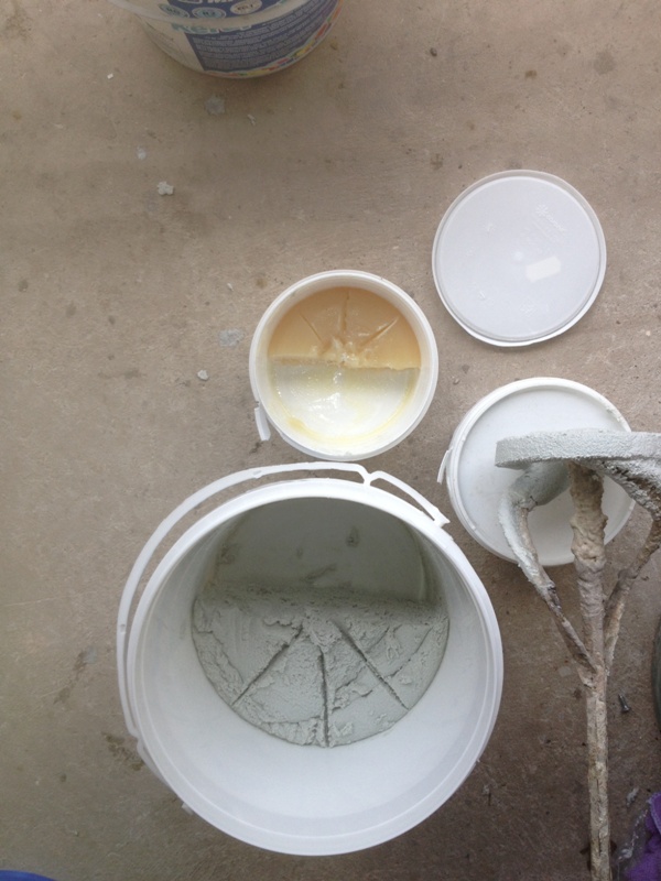

Does anyone use this method when you need to mix a small amount of epoxy, just gives me the right ratio whether I need half a tub, a quarter, or one eighth.
