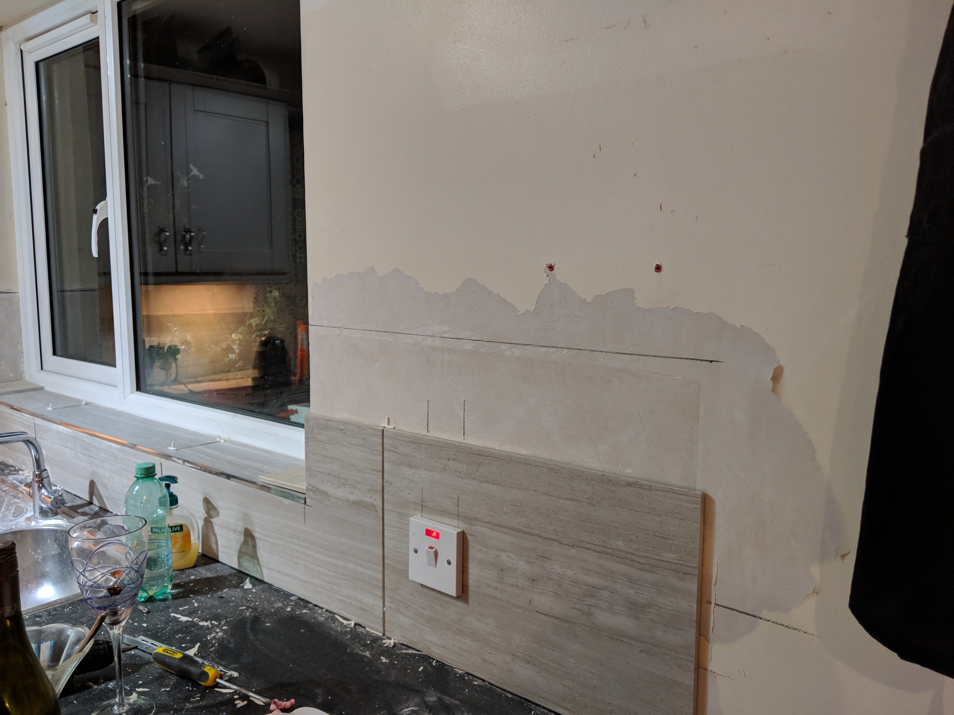

Quick question for those with more experience; started tiling my kitchen splashback this weekend. U shaped kitchen, mixed mosaic tile behind the cooker then using 600x300 elsewhere. Original plan was 1.5 tiles high at wall behind sink and window in line with end of the cabinets, now thinking of 2 tiles high instead? Is 600 too high for a splashback?
Will try and upload a couple of images!

I would normally tile splash backs to the height of the underside of the wall mounted units. This can vary but 600mm is a bit high, although 2 full tiles can look better than cuts. Or you can tile them portrait 600mm high.
Thanks for the response. Yeah think the 600 might be a little high myself. In hindsight I probably should have taken a little off the bottom row to so the grout line was more central?? Ah well, too late now!!
Cheers
Waluigi
For arguments sake a Kitchen worktop is 900mm from the floor.
Add on a couple of tiles and say 5mm for a spacer, a wedge and a little gap between the top of the tile and the bottom of the wall unit and you’ve got about 1505mm from the floor to the underside of the wall unit. To me that’s about right but it is very much a personal thing.
