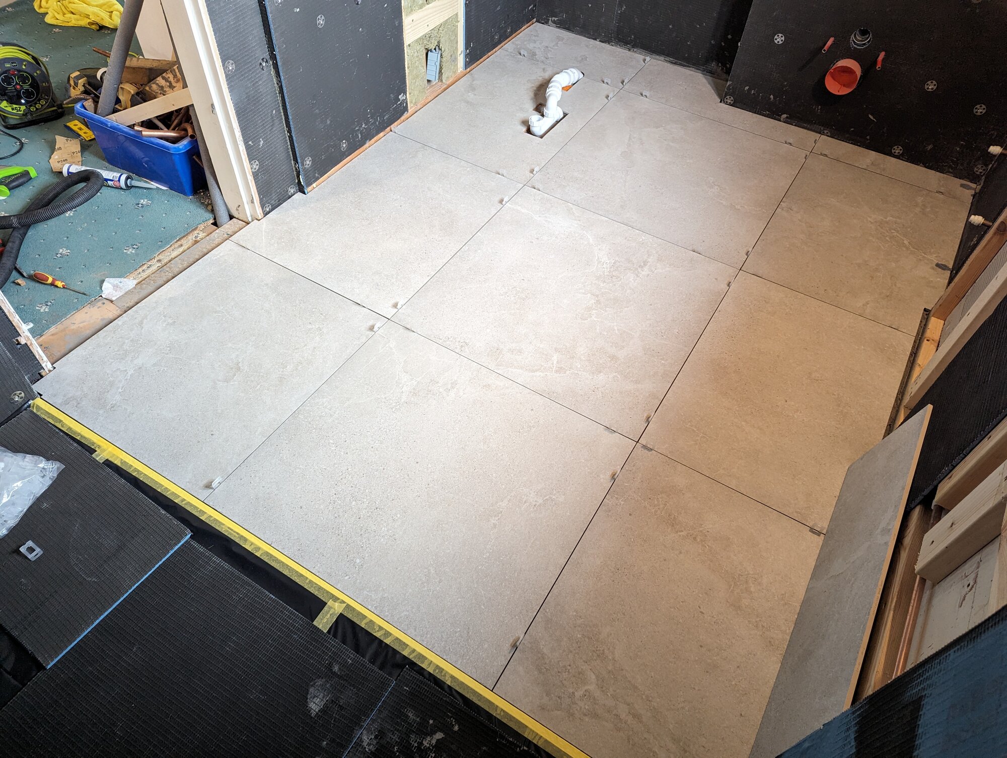

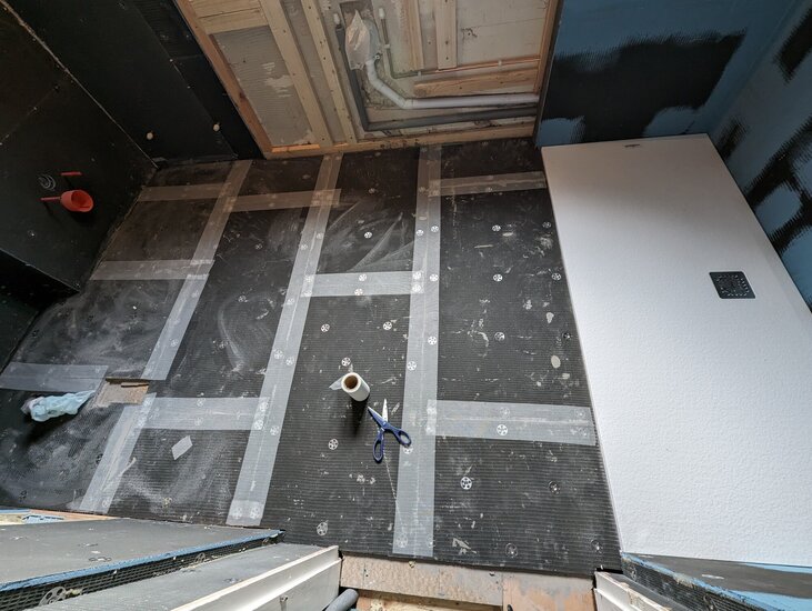

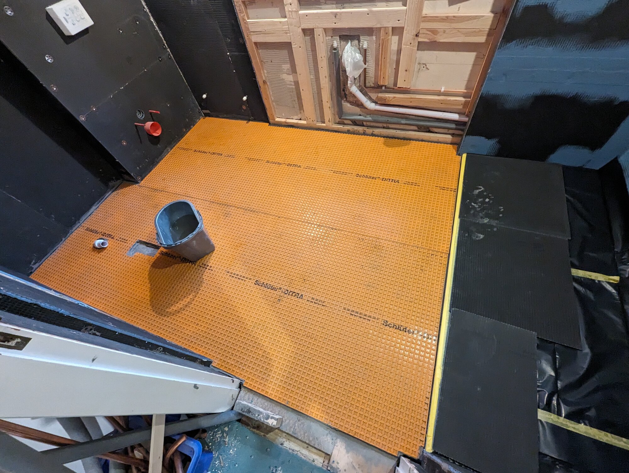

So here's the floor prep, including loose laid tiles...
