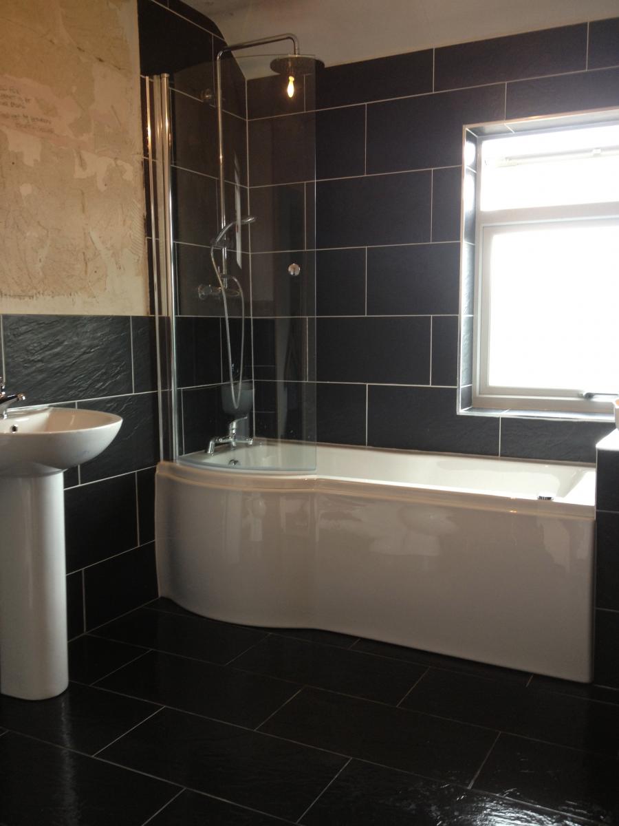

ive just done a job with a bow 22mm in the middle..porcelin 300x600...i fitted 6mm hardibacker..with fast set and screwed to wall..then the builder is skimming the wall to bring it up to back of tile...dunno why he could not of given me a straight wall:mad2:
