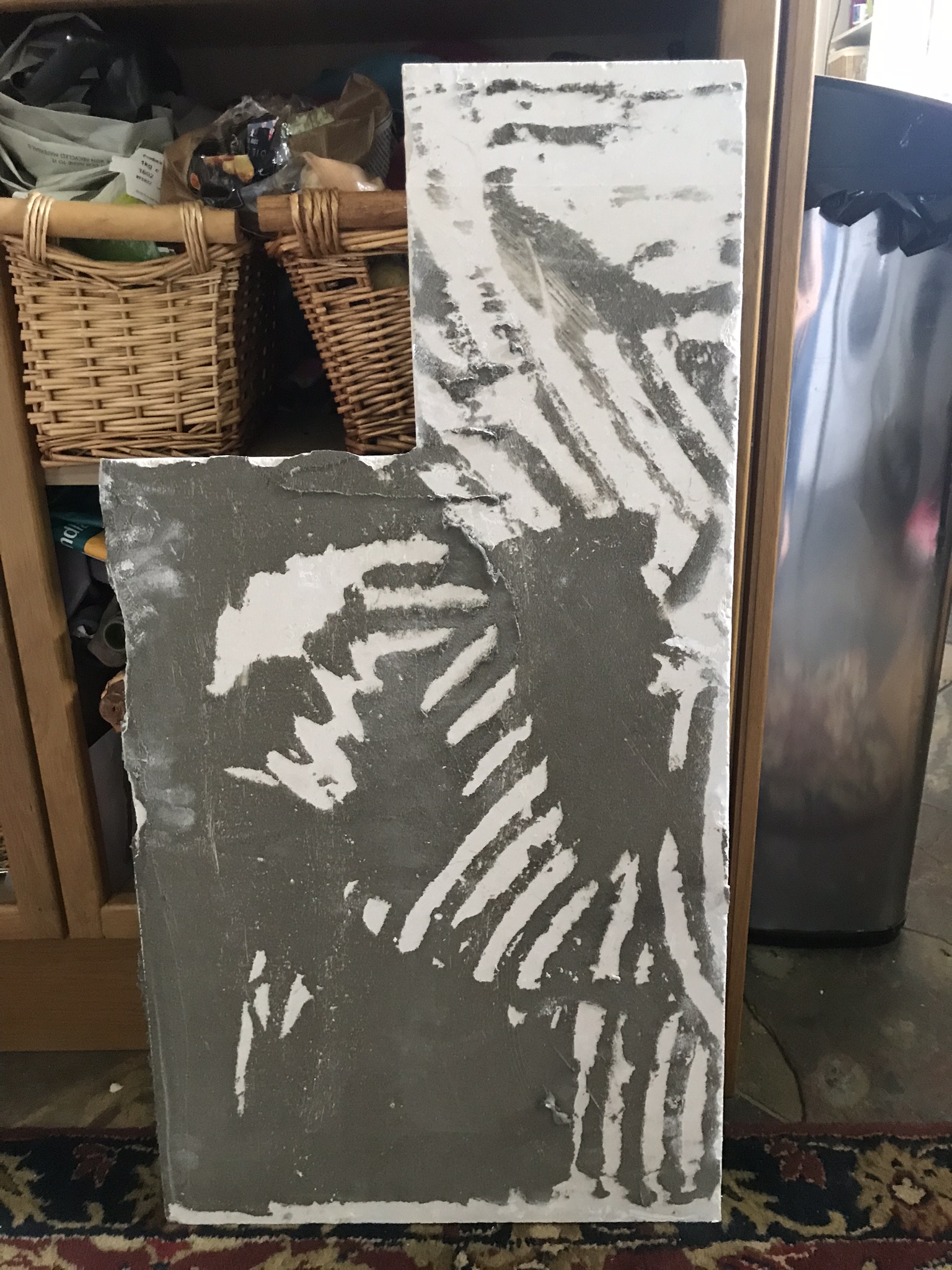

Hi, I have recently had Jerusalem Light Limestone tiles installed over a brand new wet underfloor heating system laid on the original floor (concrete over 10 years old). A decoupling mat was put down first. The appearance has significantly changed during the process of laying including severe cloudy patches. What could have caused this?

Seems to be a reoccurring issue with limestone at the moment, not leaving them long enough to completely dry out seems to be the issue, notice yours are grouted so must have been sealed now trapping in the moisture I'd presume..
Just wondered what happens during the laying process that makes the moisture darken the tiles?
J Sid
Also most of these tiles are stored outside, even if the pallet has plastic around it it will sweat and the stone will take in a lot of moisture. That all need weeks of drying time after being layed before sealing and grout. Customers need to be patient, most out there sadly don't want to wait and then they end up with this.
Thanks for all the comments. So... if they are now sealed/grouted/sealed, will they ever dry out or is the colouring permanent?

The 6 litres of water mixed in with every bag of adhesive has to go somewhere, and as you've got an uncoupling mat down only place is up and out through the stone..
thanks for the comments. The adhesive that was used was Tilemaster Adhesives Ultimate Grey C2 F S2 20kg. This is supposed to be rapid set - would moisture from the mix still have caused this do you think?
