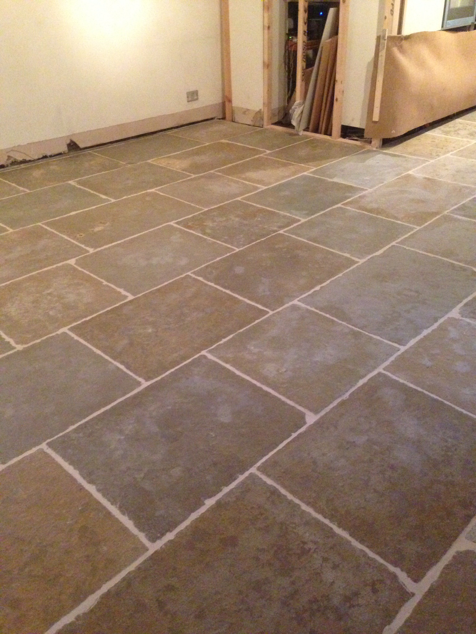

5 - We'd like wide grout joints (like the photo above) - are there "spaces" out there that can achieve a wide joint or do I just do it all by chalk line?

You can get spacers that are quite big but realistically as long as something is a constant you can use anything. Window packers that window fitters use are a god send. Easy to pull back out after too if you leave them sticking up right so you pull them out as you go along.

That's Bastille limestone and a very hard tile..... You space them by eye as the edges are uneven .
Solid bedding as per the norm but make sure you work clean and seal before grouting once clean and dry , the brushed surface can grab grout ...

Same stuff I think, jasmine grout
As Dave said, solid bed plus back butter the tile.
lay ditra or tile master have one which is very good, easy to cut and only .85 of a mm thick .
Personally I'd use standard set white if your a novice, cut in as you go along,don't leave until last, as they will be different size widths/lengths .
Sort thick to thin, as again they will vary , use thickest 1st.
A must is sealing before grouting, even then , with them being rough tiles I have a lad behind me sponging off excess around the joint , not over the joint, just gently around .

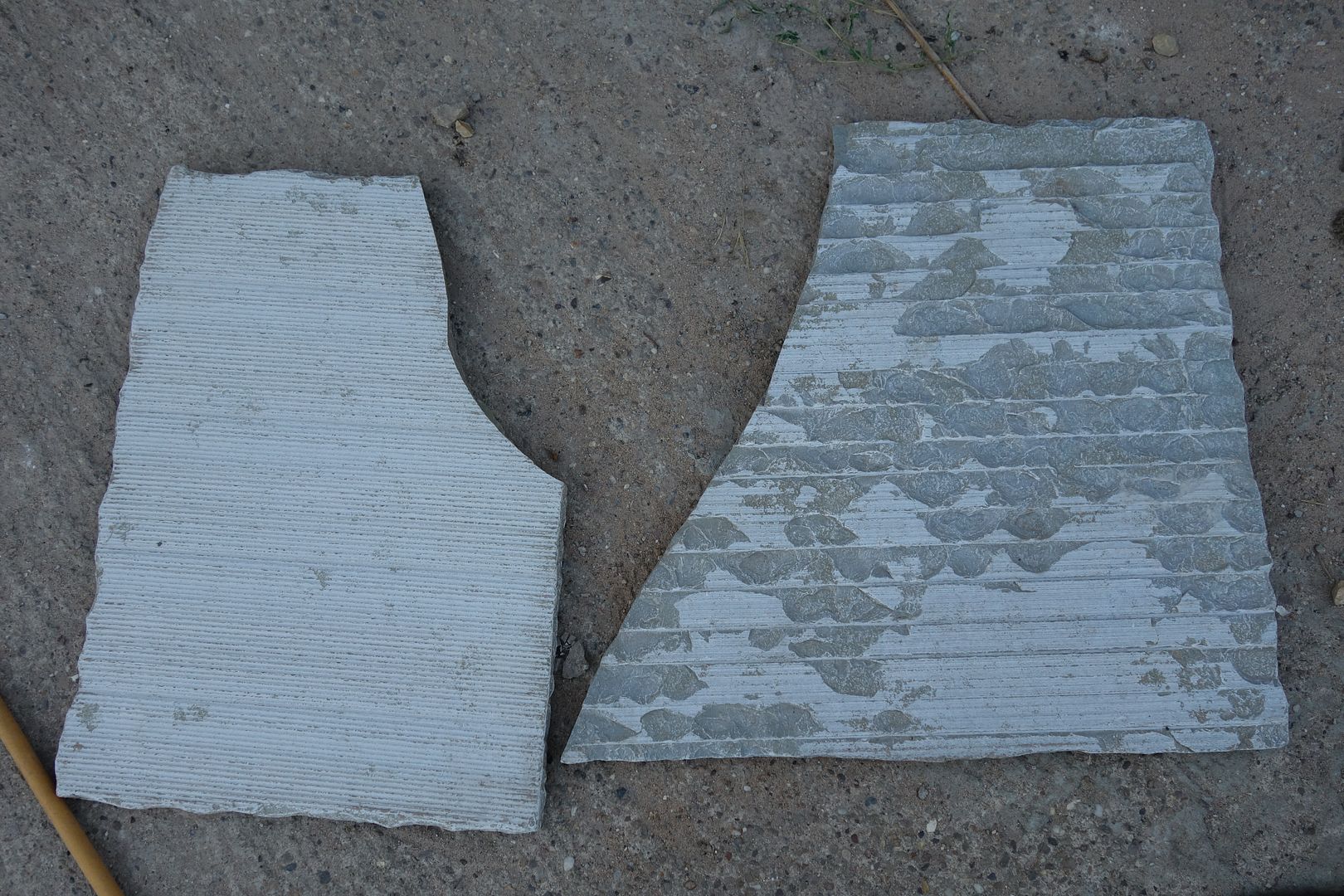

A good grade Bastille should be +\- 2mm , that won't be noticeable on this type of tile as the joints will range from 5mm edges to 20mm etc on the corners.. If the backs are sawn finish then deffo double bed if flat finish then back skimming as Craig says is a must anyway...

Ahh okay so on an average bed of adhesive you're not going to spot the thickness differences.
Nope , these tiles are slightly uneven anyway on the face ... Laid crates of it ... Really nice and very hard wearing.

Yep , that's Bastille...
