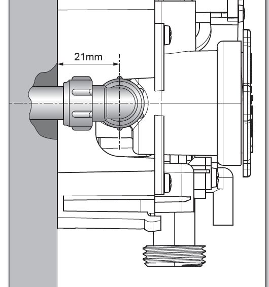

I will be fitting the shower shown below with cable and pipe penetrations through the wall. I know there is a 22mm collar that can be fitted for the water pipe. Does this allow you to slide the pipe in and out a bit when you go to connect it up. Similarly what about the electrical cable.
And what about screws that must be fitted to secure the riser rail. Do you seal these when fitting.
