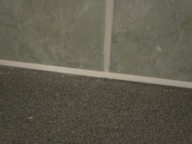

There's a multitude of methods used to varying degrees of success but there is just one single factor that determines wether the method used is a success or mess and that is:
YOU MUST LAY DOWN A CONSISTANT LINE OF Silicon
with every single method, which is of course the one thing that most people struggle with, hell if you're good enough you could use the cap of a felt tip pen.
The exception to the rule is of course:
Well you work it out.................:hurray:
no skill required :thumbsup:
faster :thumbsup:
consistant :thumbsup:
less mess :thumbsup:
less stress :thumbsup:
And at the new much lower retails you can't afford not to use it, hehehe.
nuff said,
Cheers
Andy
