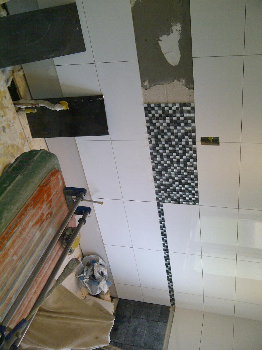

Im doing a little shower room t the moment which i have to return to on Wednesday. The customer wants a border of ceramic mosaic halfway up the wall but also one at floor level like a skirt around the room.
The wall tiles are only 250x200 ceramic so not particularly heavy. But i wanted to crack on when i return on Wednesday. Has anyone used these backing sheets for mosaic sheets? We got the mosaic fairly cheap and some are a bit tatty on The mesh. Was thinking of trying these backers out to one get them back in some sort of workable order but also so i can maybe get a few rows of tiles on The wall as well rather than battening and putting mosaic in later or waiting for adhesive to harden before i carry on.

As Rookery says they are less than a quid at CTD. Iv'e used them a few times now and find tham great on mosaics that have a weak mesh back. They really do strengthen the mosaic and also help to bring level to the main tiles. You can use more than one layer to help level them if needed...its then just getting the adhesive bed right so that it meets the rear of the tiles and is not just holding the mesh youv'e added.
