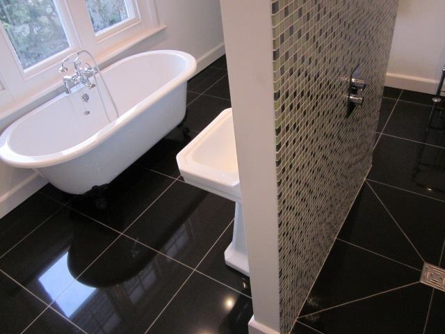

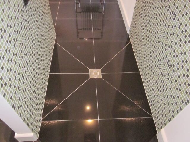

As all above, grout on the edges will be just fine. Here is one if my glass mosaic jobs finished on the edges with just being grouted

just done 6 high class new builds and all en-suites were tiled to ceiling in shower area and finished to top of mosaic round the rest of the room, sq edge stainless trim all the way round and down sides of shower for those looked nice, easy mitres too...backer sheets of mosaic mesh should sort the difference in tile depth and make easier to fix
