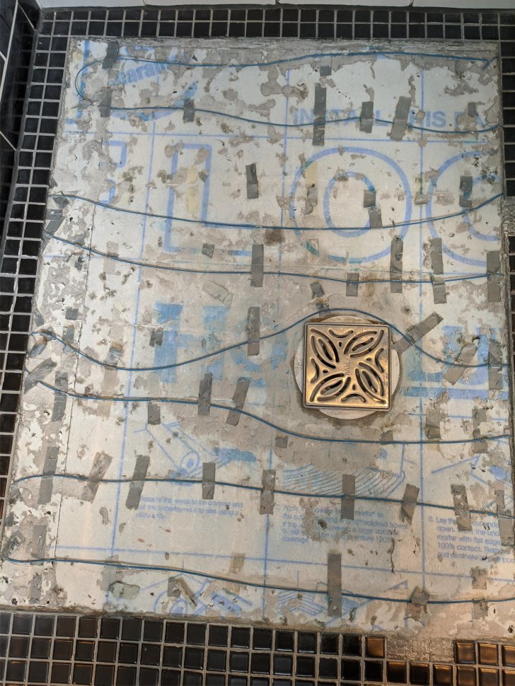

That's a picture of it currently if that's any use?
Perfect Tiling
Its hard to see what type of tray has been used as what you can see here is a homelux decoupling mat that has been stuck to the tray as part of the waterproof tanking. The fact that you can still see the writing shows that the adhesive wasn't stuck that well to the mat. If the mat is undamaged and still stuck to the tray it may be OK.....you can't see if its been damaged...but then again you can't see if it hasn't been. I'd isolate your UFH though....don't use it without tile coverage.....the installer hasn't been keeping it evenly spaced. I don't put it into the shower itself....by the time you go into it the warm water has warmed the tiles and the extra heat can dry out the water trap leading to smells from draughts back up the waste.
Wetroom specialist
Sorry, this reply may be a little late but I haven't been on here for a while. A number of things took my eye. Firstly it looks like an old AKW Drain, they have a range that they don't promote much called "Level best". If it is, then there is a strong possibility that it's an AKW floor former possibly / probably TuffForm. It looks like the installer has then sourced his own cheaper tanking, possibly Homelux fleece membrane at a guess, because AKW have never sold Homelux tanking to my knowledge. While you have the UTH exposed you might want to move it away from the drain a little if possible. Now it should be evenly spaced so you may not be able to do this at this stage. But UTH should always be kept around 150mm away from the drain. Don't worry, it isn't dangerous. The reason is so that if you were on holiday for example but your UTH was on a timer. It could evaporate the water in the trap. This will result in a smelly bathroom when you get back. Finally, it could be that the floor hasn't been strengthened enough underneath the floor former so that there is NO MOVEMENT. If this is the case (and it's what I suspect) the floor former will move, the adhesive will then fail due to the movement along with the grout. This will result in this situation. There are two valuable lessons here. Always buy your wetroom products from one source (guarantees are not so easy to get away with or avoid). And always always always support your floor former with 18mm ply between the joists, even if the manufacturers say that you do not need to. Tiles do NOT like ANY movement.
