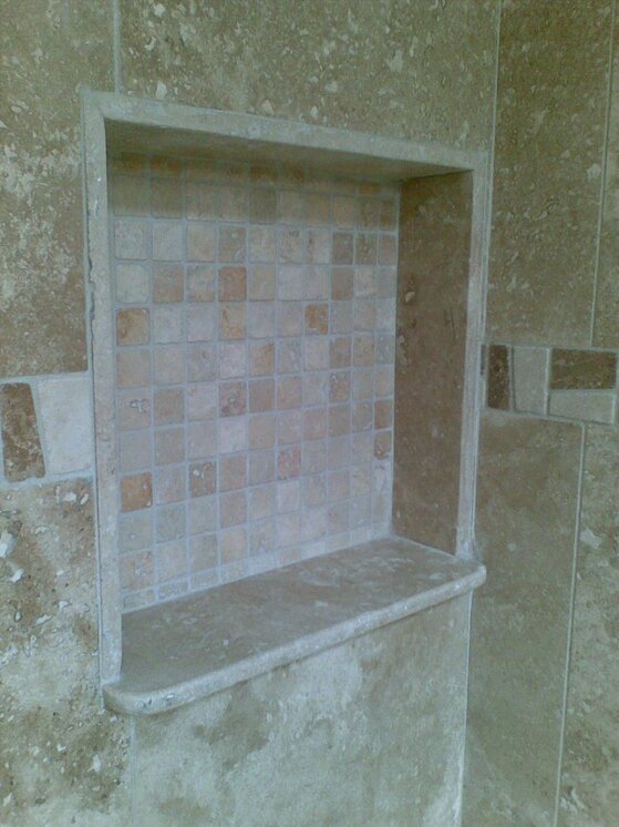

I just butt joint them & give them a polish once on the wall. As previous posters have said polish using a polishing pad on the angle grinder.Practice with an offcut first to see what grit pad will give you the same finish as the face of the tile.
Mitres are not much chop with travertine....it's way too soft & will chip easily, esp. while your cutting the mitre.Though if your using unfilled travertine the grout can take this up. I had a client who insisted on this once & while the finish looked good it was a pain in the backside to do.
An example of butt finished is in the attached photo....on bath & window sills.
