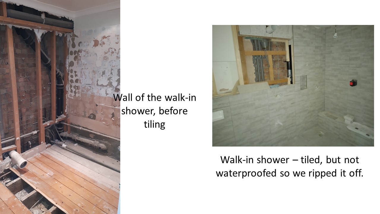

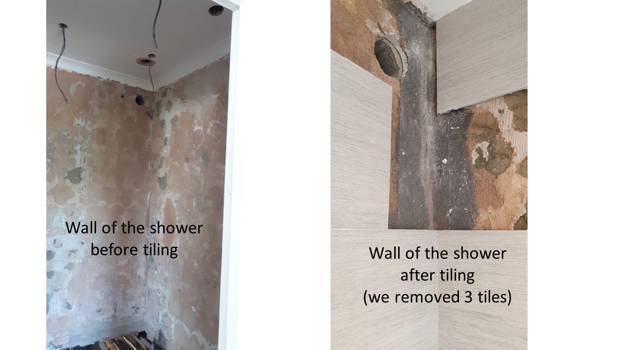

For the 3 bathrooms, they have removed the old tiles and underneath, there is brickwork with some patches of orange plaster and some cement. It was really uneven, with little grooves, etc. They seem to have tiled straight onto this substrate. Applied the tile adhesive without any waterpoofing paint/coat. (and of course no board)
None of the walls around the walk-in shower, around the shower tray and above the bath have been prepared, they have not been re-plastered / made smooth,
The tiler and builder assure me that we don't need to waterproof the walls. which concerns me as I read everywhere that we should tank the room, ideally with boards or with a waterproof membrane or coat.
The tiler says that the grout is waterproof and water won't going behind the tiles. which is, I'm sure, incorrect, as over time, buildings move and this creates little cracks in the grout etc...
For the walk-in shower, the first tiler who did the job admitted he didn't waterproof the junctions (corners between walls and junctions between wall/floor/bench) with a waterproofing and anti-fracture membrane (Kerdi-kereck or Mapeguard type). So our builder ripped out the entire newly done bathroom and is now re-doing it (with a new tiler).
Now, the wall (initially the brickwork with some uneven plaster/cement on it) has a really thick (1.5cm) layer of tile adhesive. that the tiler doesn't want to remove (he's telling that "it will be a perfect surface to add the new tiles on this". Really?). This time, they are planning to add a coat of a waterproofing liquid on this. But I'm wondering how can you apply a waterproof coat on a wall that has so many "bumps and grooves".. am I wrong?

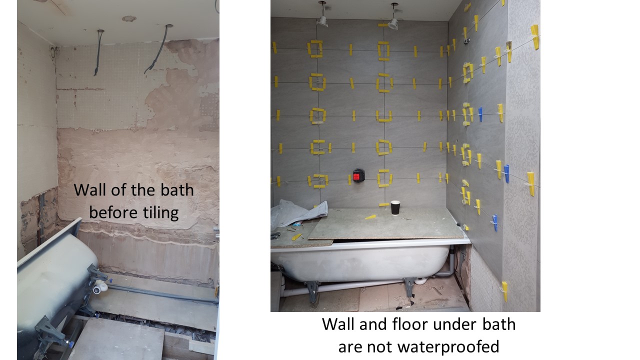

1. should they waterproof the walls around a shower, and above a bath?
2. should they waterproof the walls under the bath?
3. should they waterproof the floor under the bath?

1. should they waterproof the walls around a shower, and above a bath? - Yes, if there is a shower above the bath then I would normally tank this area.
2. should they waterproof the walls under the bath? - Not really, if the bath is fitted correctly then no water should get under the bath through the bath/wall transition.
3. should they waterproof the floor under the bath? - Not unless specified as the above info kind of applies the same

7. In the walk-in shower (which they are currently re-doing..), should they remove the dried tile adhesive, to make the wall surface flat and smooth, before applying the waterproofing liquid? - I would think it would preferably be removed but again speak to the manufacturer as they be best to advise if it can be applied over adhesive. I would be inclined to question as to why the tiles came off so easily as generally you would back butter the tiles and whenever ive tried to remove a tile which has been installed correctly it basically rips the wall to bits, yours seems to have come off easily from what I can see on the picture.
8. Or should they tank this wet room with waterproof boards (instead of using a waterproofing liquid)? - A wet room in my opinion needs to be constructed of backer boards like wedi or kerdi etc in the wet area i.e. shower and floor, the other walls in the room could possibly just be tanked.
