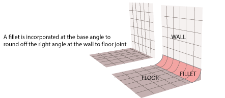

hi guys and girls, i have tiled a balcony but the customers not happy with the end result, he's been told by a roofing company that plastic fillets can be tiled, now i must say the fillets are plastic, hollow and are very flexible
the customer want me to tile the fillets and wall but I've told them there is no way of tiling something flexible or plastic regardless of who's told them , so only the balcony can be tiled not the fillets or wall, any advice would be great and if there are any reps out there who can back me up , id really really appreciated an email so i can forward this on to the customer
I've posted a pic below to show what i mean

Hi Jason, after viewing endless balconies in and around Lytham, St Annes and Blackpool I decided I wasn't confident tiling any of them (they had all failed before I got asked to look at them).
I went on the Schluter balcony course and it was a real eye-opener.
There is only one way to tile balconies now as far as I'm concerned and that's the right way.
Anything less is a major risk. I'm not saying Schluter's products and systems HAVE to be used - but the principals involved in their designs are essential imo.
Seriously - get yourself on the course and start mopping up all the balcony work in your area.
