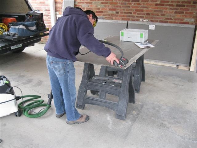

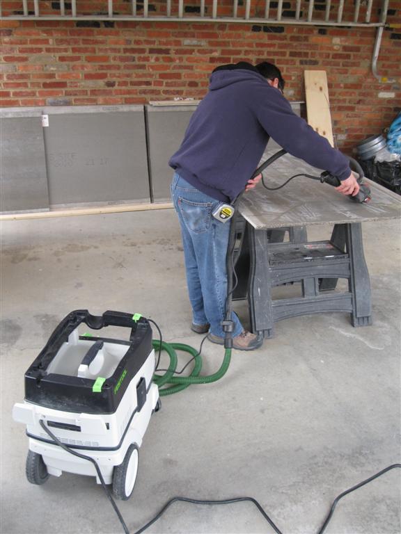

FYI to everyone that uses cement board...this tool is new to our company (since last Fall).
When attached to a good vac, and when the cut is made pulling the tool toward the user (rather than pushing away ), dust collection is nearly 100%.:hurray:
If you use a lot of cement board or Hardi, you'll love this and your lungs will feel better, as well.:thumbsup:
