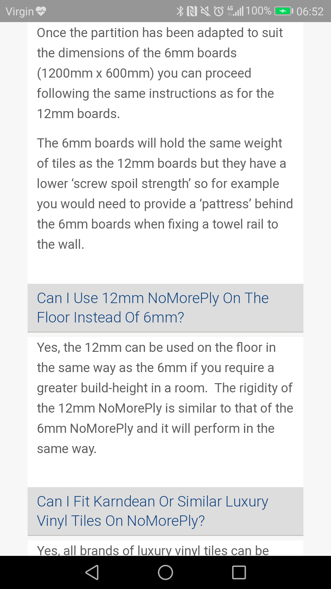

Actually, if you read nmp's literature then you'll find that overboarding with 6mm and 12mm adds the same strength according to them. Cross laminating them would add far more strength in my opinion. To strengthen the floor permat would be the way to go

One 12mm layer will be cheaper and quicker than two 6mm layers.........if it was even needed in this case,which seems doubtful!
Looks like overkill and added difference in height to the floor

No tiling on ply is a thing of the past.. if you are happy with the additional height, just put one 12mm NMP down and you'll be sorted, but as others have said, if you dont need the height, one 6mm NMP should suffice
