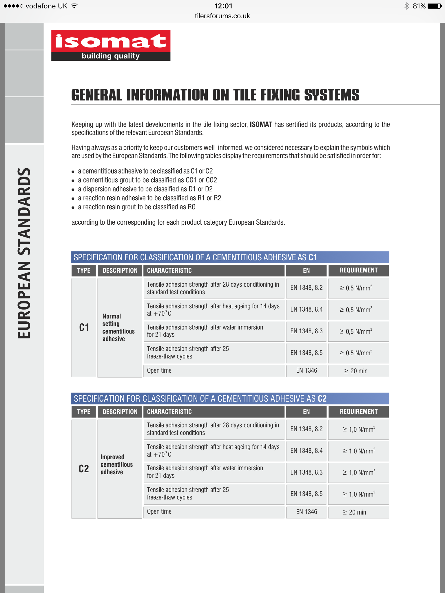

A while back I posted a question on the quality of Norcros adhesives in general.
This time want to know if anybody has experience of using Norcros "white porcelain and stone tile adhesive" with porcelain tiles on walls and would they recommend it?
There are 3 types though:
http://www.nxadh.co.uk/product-categories/powder-adhesives/
If not what would be a good alternative?

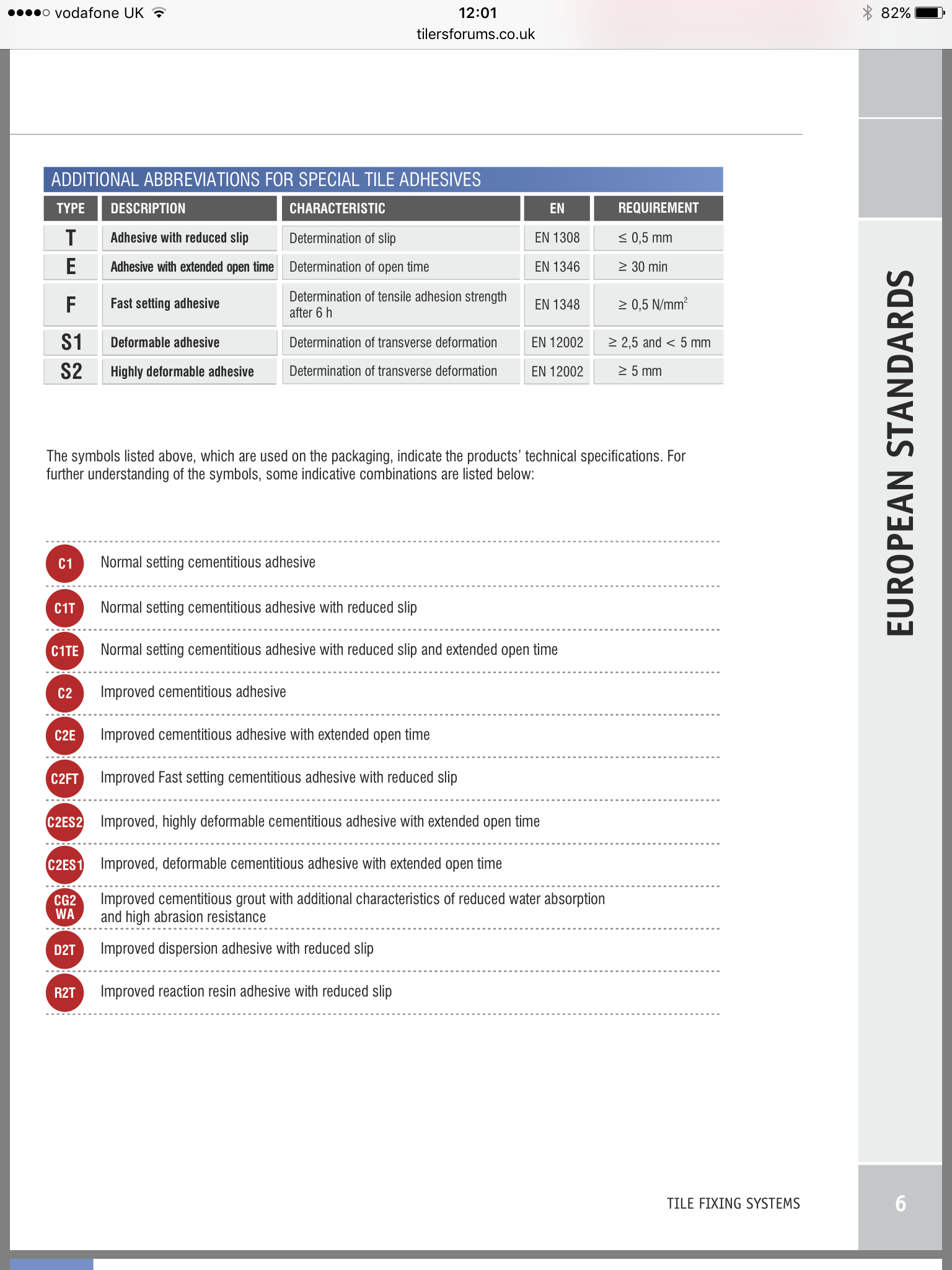

ISOMAT technical support
Generally speaking quality of tile adhesives is described on the bags, the classification is determining the quality, see the attached explanation. Good luck
