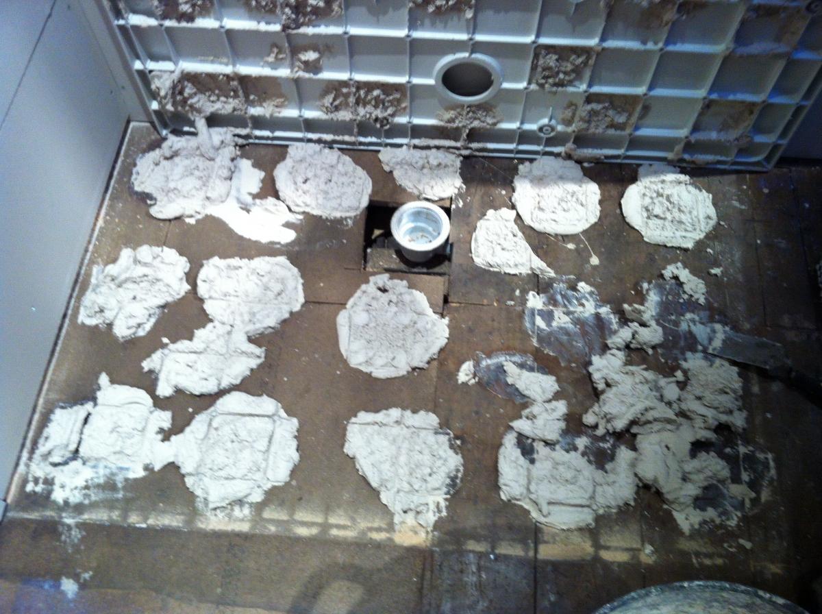

Went to start a bathroom today after plumber had first fixed and set shower tray in place.
Cleaned up floor, checked for deflection and everything was fine. Started to prime floor ready for backer boards to go down and leant on the tray. Oooh that moved....so i tried to lift corner of tray up with my hand and it moved up and down 4-5mm.
Rang plumber and told him tray was moving and wasn't expecting it to seeing as he fixed it last Thursday.
"What did you fix it with?" I asked.
"Tile adhesive"
"I'm sure it should have gone off by now" I said laughing
"You would think so"
"What tile adhesive did you use?" I asked
"That ready mixed one"
So I asked him to hold on, I lifted the tray up by hand and this what I found
Anyone care to comment?
