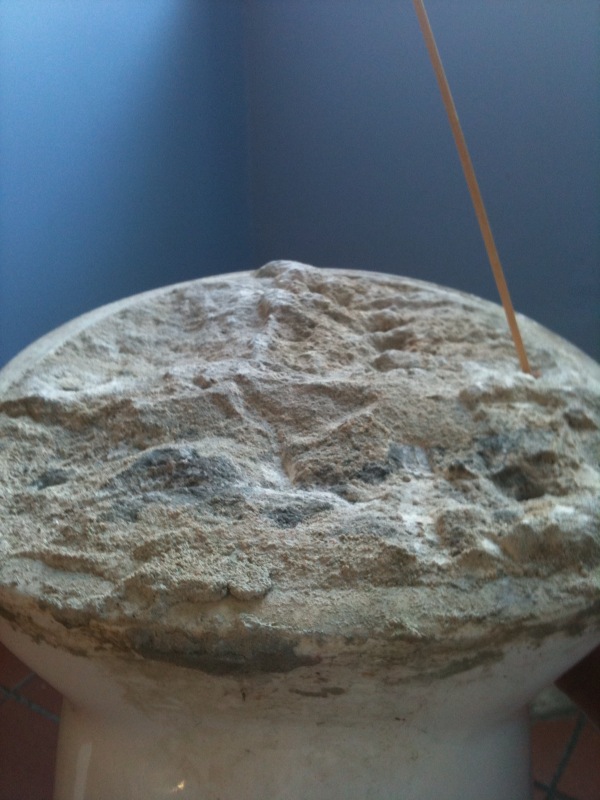

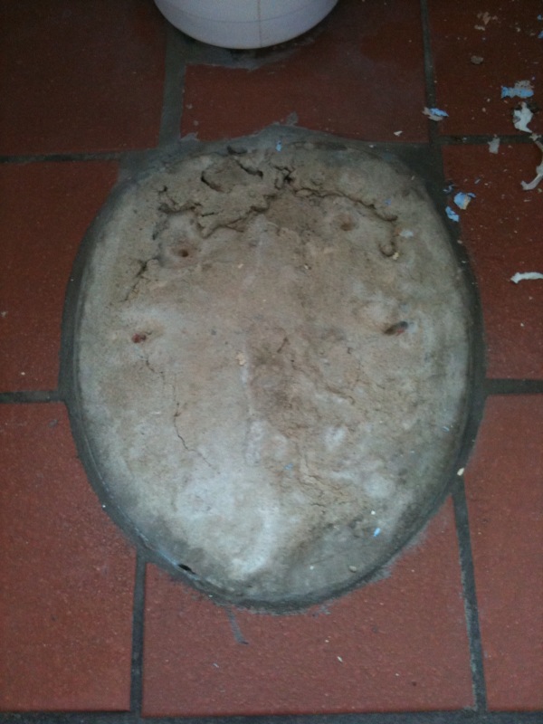

I have an existing toilet pan which rocks. On removal I find that it has been set on a mortar bed with four much-too-short brass screws for anchorage. The mortar appears a little crumbly in places so the screws have pulled out and the pan come away from the floor. I now have mortar on the floor and the negative impression on the base of the pan. In addition it has completely crumbled away round two of the screws leaving a void and the concrete floor beneath it visible.

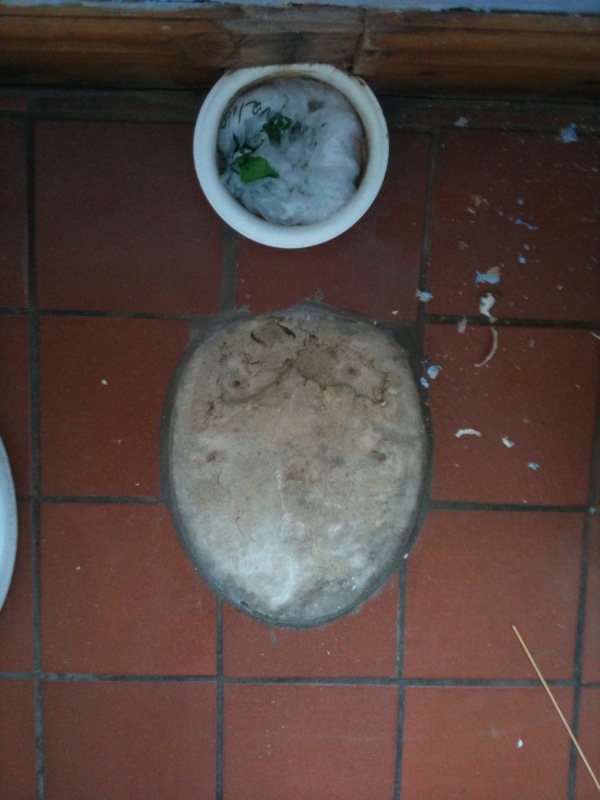

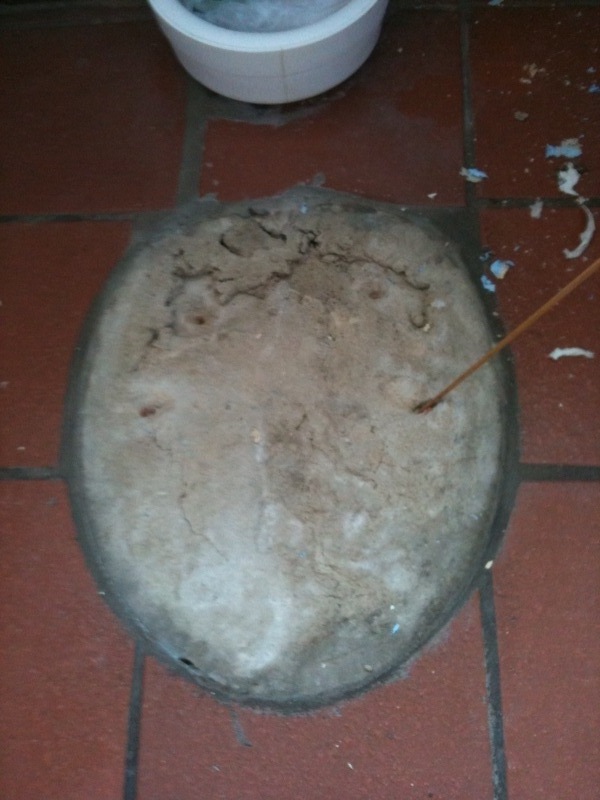

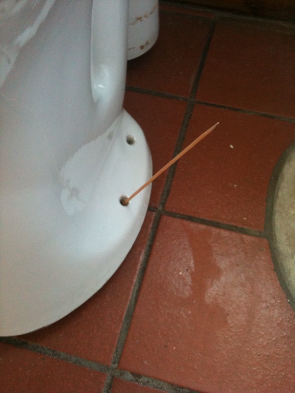

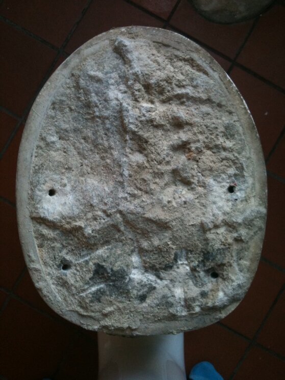

Here are some photos to hopefully clarify what the situation is.
I could chip away the old mortar, but risk the floor tiles.
This would also still leave me with the uneven mortar on the pan base.
I have measured up and the Fischer fixings at 82 mm would be long enough to go in to the concrete base, assuming I can drill and plug at the correct angle freehand.
If I can get a reasonable fixing with two sets of Fischer screws and use a bit of silicone perhaps this would hold it?
Thoughts appreciated, thanks.
