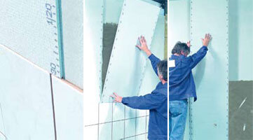

i understand were your coming from , is this all plaster boards in sweden . i.e the green boards moisture resistant
They are Extruderad polystyren, cement based or fiber glass.........I use the ones on the photo
