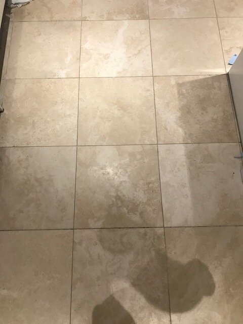

Please help me. Really having a nightmare here. Just moved into a new house and the kitchen has a lovely travertine floor but its dirty and neglected. I have a really nice dewalt rotary car polisher and read up about travertine polishing and people say to get diamond polishing pads. Started off on 800 grit then worked up to 3000. Tiles come up really clean and look good. Major issue is that the polishing leaves white chalky dust behind. I have mopped, dusted, scrubbed etc but the white chalky dust just comes back as soon as the tile is dry. I go to a tile and agitate the surface with some warm soapy water (this is after I have polished it). I then mop it and let it dry. Then I dust it. This removes all the chalky dusty stuff and it goes back to its normal colour. Within 5 minutes its all back again???? Any ideas? These are the pads I have:

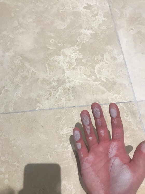

Now managed to attach some photos. Pic one shows the tiles dusty. Pic 3 shows what comes off if I wipe my palm over it and pic 4 are a set of tiles that have not been cleaned or polished for colour comparison. When I mop and dust the tiles after polishing they do look like the unpolished ones in terms of darker colours but the white chalky dust return in minutes

Morning, first off it really didn’t need honing/polishing. A simple clean with a suitable none acidic stone cleaner would have sufficed and then re-sealed.
Don’t wet the floor anymore as your bringing up salts from within the stone. Keep buffing with a dry cloth until the salts stop , this could take a few days after the soaking it’s had and then re-seal with a breathable stone sealer. There are a few sealers out there so check with your local suppliers as to what they stock.
Lithofin, fila etc are all good brands.

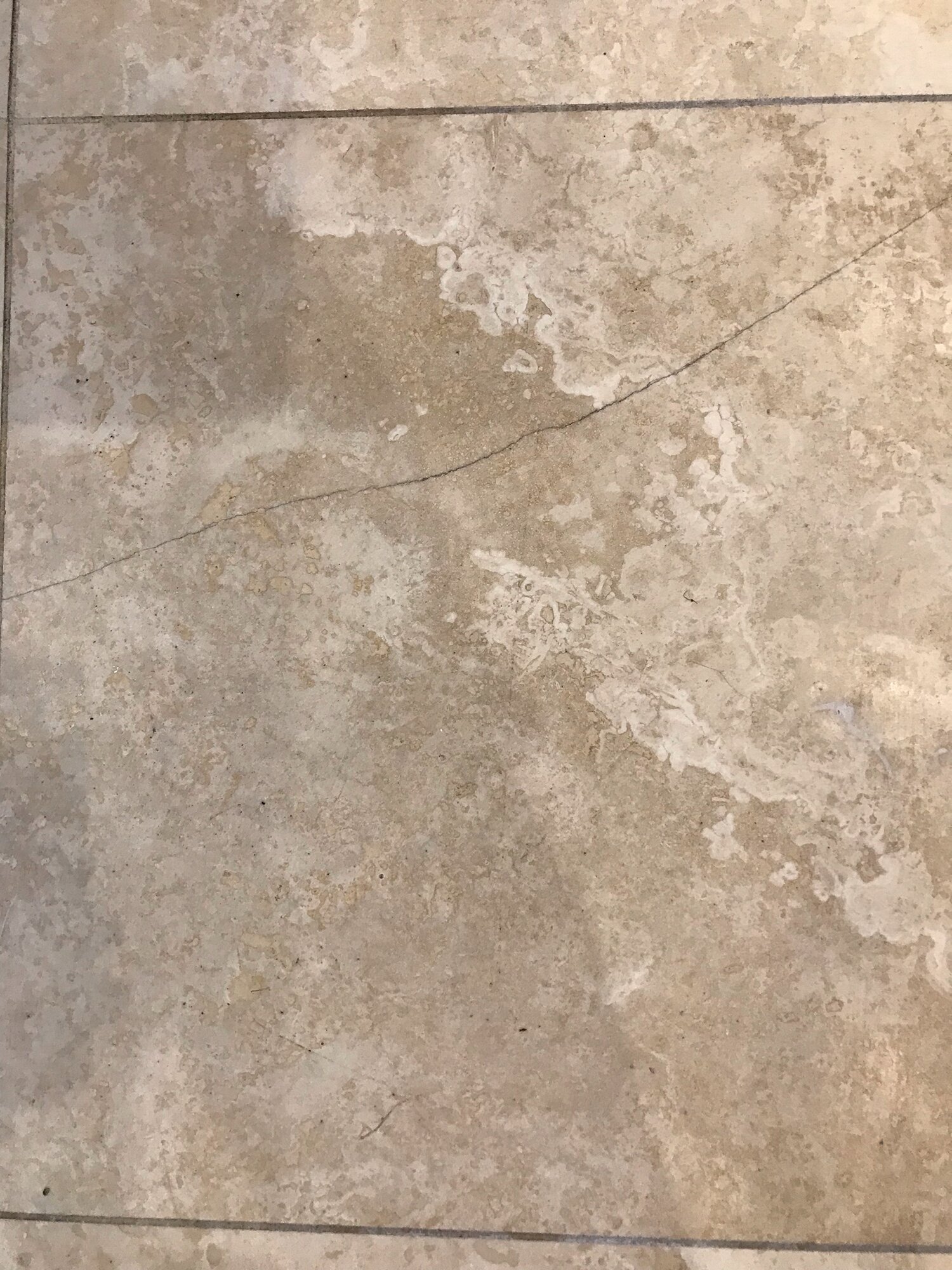

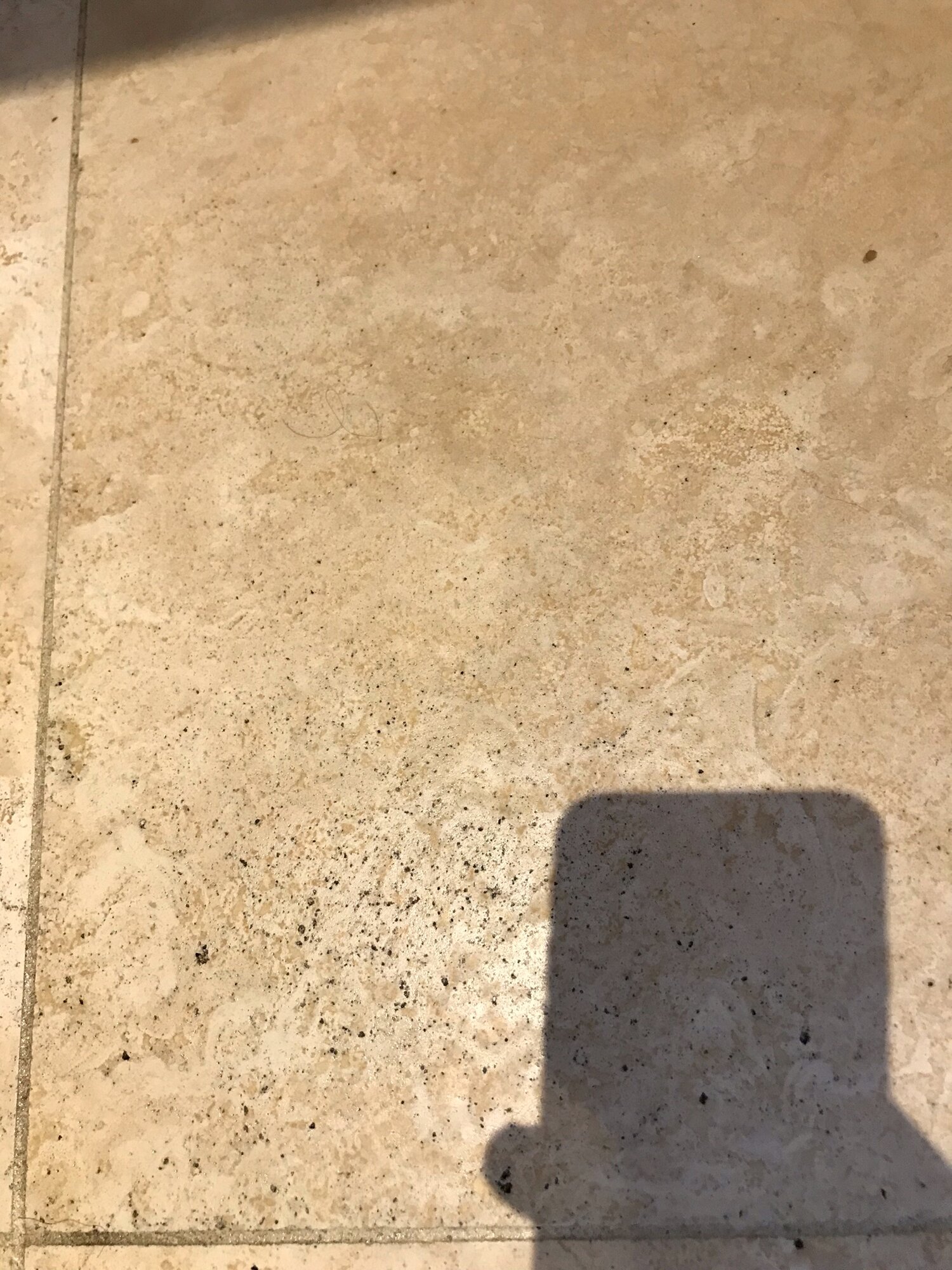

Thanks! A few more questions I have now I am deeper into the job if you (or someone else) would be so kind. Firstly, a small number of the travertine tiles have black dirt engrained deep into the tile (see attached picture). Even honing these specific ones didn't really work in removing this nor a deep clean. Any suggestions? Secondly, some have hair line cracks all the way across. I have some travertine filler but was wanting some confirmation on the best technique for cracks this fine? On YouTube they seem to suggest raking it out with a razor blade/stanley knife then filling once deeper?
Thanks for any help offered!
