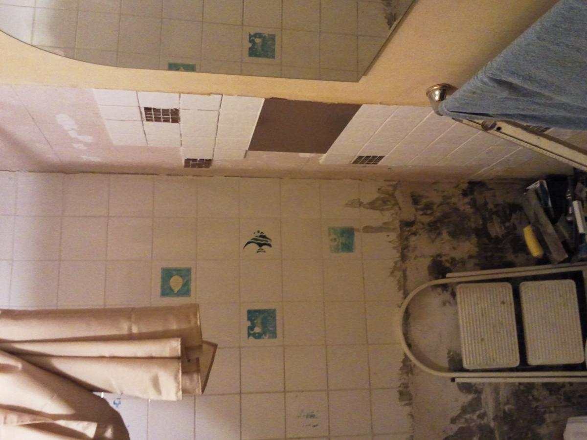

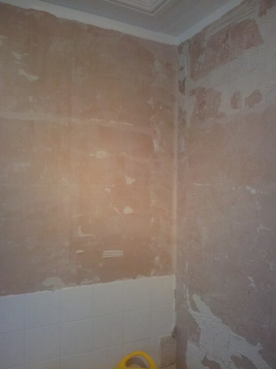

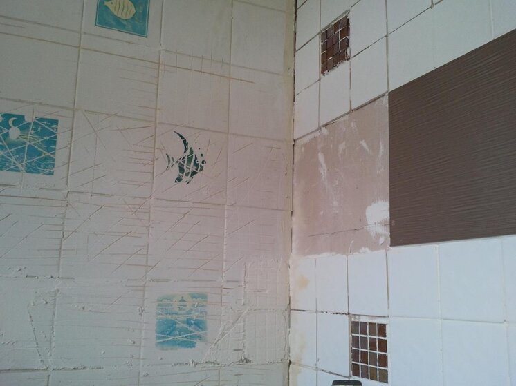

3, tile over tile is wrong IMO....you didnt fix them originally so how do you know they are secure and will take the weight of the new tiles?. I recently was asked to tile over tile...I declined but said I would remove and hope there was not too much damage ....I neednt have worried... 20120405_084501 [800x600].jpg Even though by tapping them , they sounded solid !
