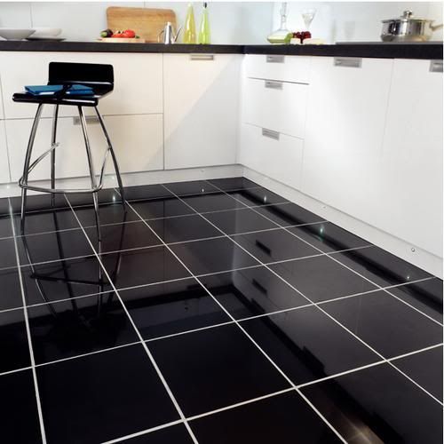

This ia p pic of polished porcelain i was expecting to see in b n q but certainly didnt look like this, is this how polished porc are ment to look
Wickes and a few decent people have left feedback
http://www.wickes.co.uk/Polished-Porcelain-Tile/invt/166297?source=123_4
So then gulf stone tiles are not suitable for UFH
