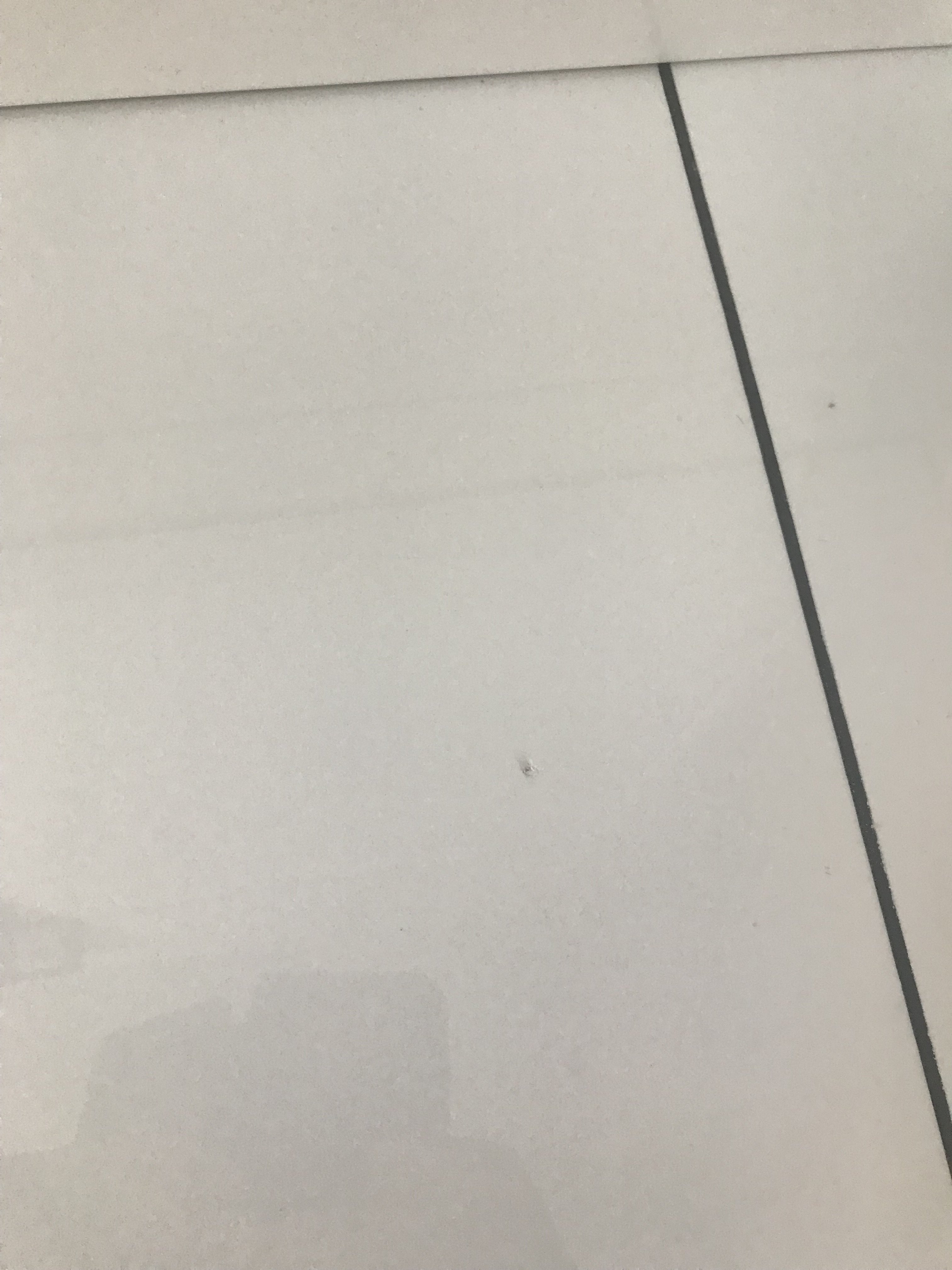

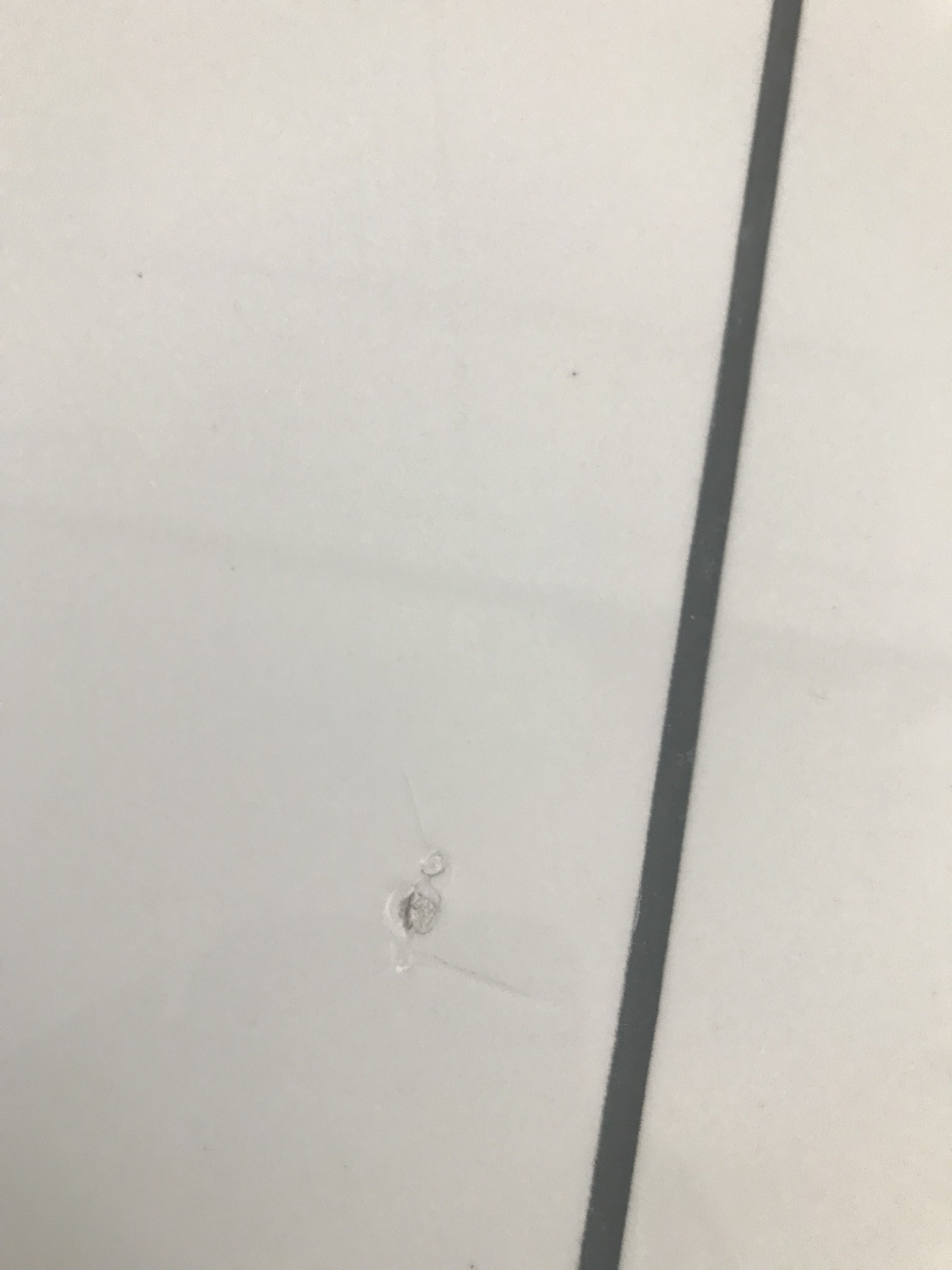

We have just had B&Q fit a kitchen but although we have had B&Q tiles also, we got an independent fitter to level and install the floor as he was half the price of B&Q. We think he did an excellent job, however a couple of tiles have chipped within a month - not at the edges but in the middle and on the top surface. Plus, I have dropped a mug which landed between 2 tile edges and has damaged 2 tiles. Our previous tiled floor had been down for 14 years and was intact, which is why we chose tiles again for the floor. I feel it is quite normal for things to be dropped in a kitchen every now and then and many things are heavier than a mug (the mug didn't break!) B&Q have said that in good faith, they will provide us with 4 replacement tiles but said there is no evidence that the tiles are at fault, ie it could be the installer, so it would be at our cost to re-install them! We are not happy that this floor will last the length of the kitchen and so I just wondered what people's thoughts were. Is it common for porcelain tiles to randomly chip and be damaged so easily? I want to take it further, possibly a small claims court as I would prefer to have the floor taken up and have totally different tiles at B&Q's expense - ie reimburse us for our expense on fitting a poor quality floor and a refund on all of the tiles. B&Q have suggested we take it up with a Furniture Ombudsman. Has anyone had experience of this and any idea if we would have a case? Any advice appreciated.

They are glazed porcelain by the looks of it. When you say ‘randomly chipped’, they look to be chipped due to dropping things, which can happen to any tile, although this kind of glazed finish is more susceptible than some other finishes in my experience. B&q tiles are generally of the lower end when it comes to quality, and that’s reflected in the price.
Waluigi
Very difficult to say. That top photo you can’t rule out an installation error. Not enough adhesive at the edge. On the other hand it could be a poor quality tile. Very tough situation, I’m not siding with B&Q but they do have a point.
I’m doing my kitchen next year, I’m fitting LVT without doubt. Too much stuff to drop onto Tiles in a kitchen IMHO.
