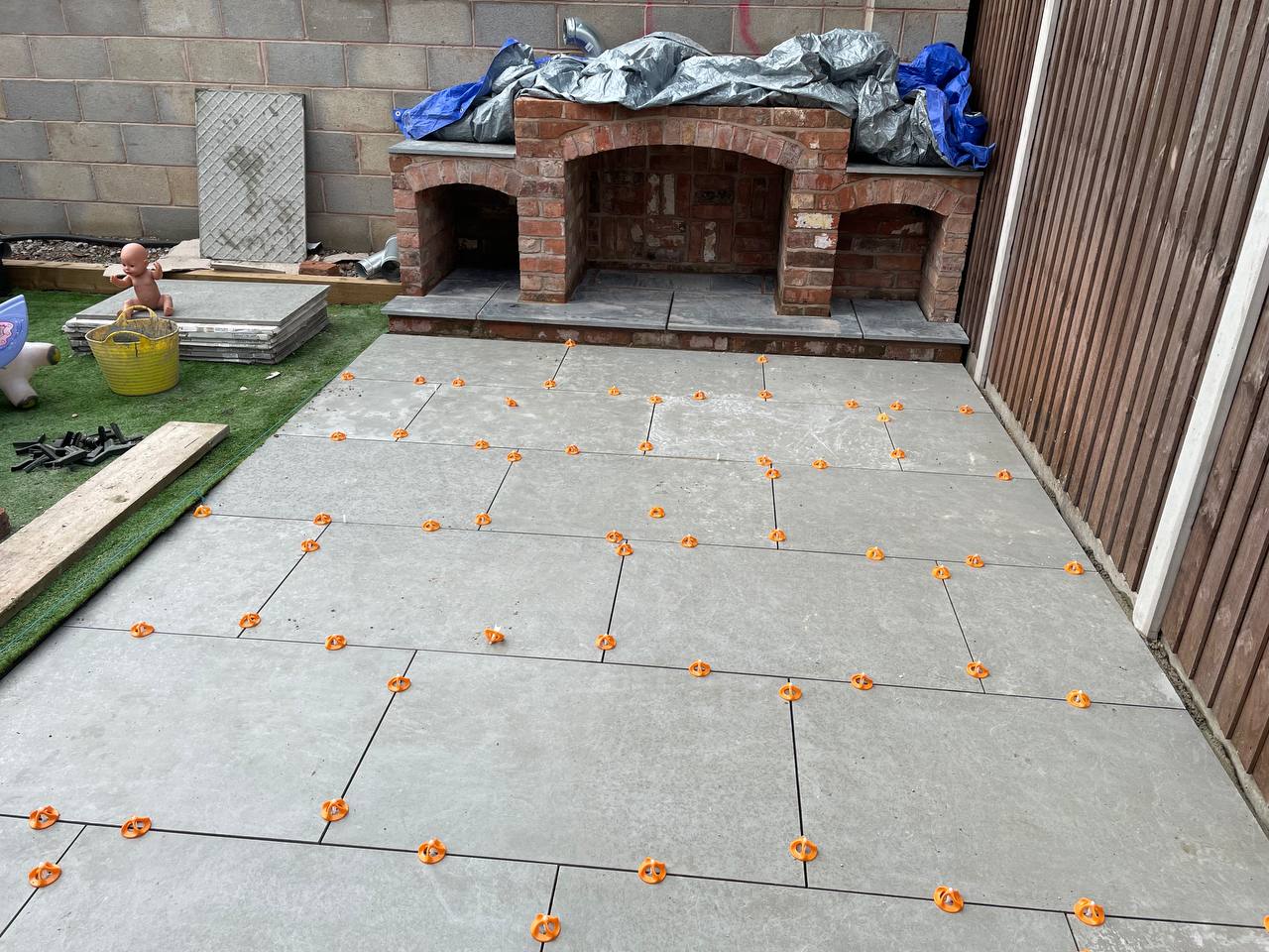

A friend of mine (who is a great brickie) laid his patio the other day, he used a wet bed of sand and cement and back buttered the tiles with a sand and cement slurry.
He didn't use a decoupling mat or cement board, just a MOT base.
He does a lot of stone paths and patios like this but I have my doubts as to how this will stand the rain, sun and frost.
What do you guys think?

Can't see the need for uncoupling outside. In fact in many cases it would seem counterproductive. Can't see a reason why this should fail anymore than any other install. Looks nice too. Might get a bit slippy though.
