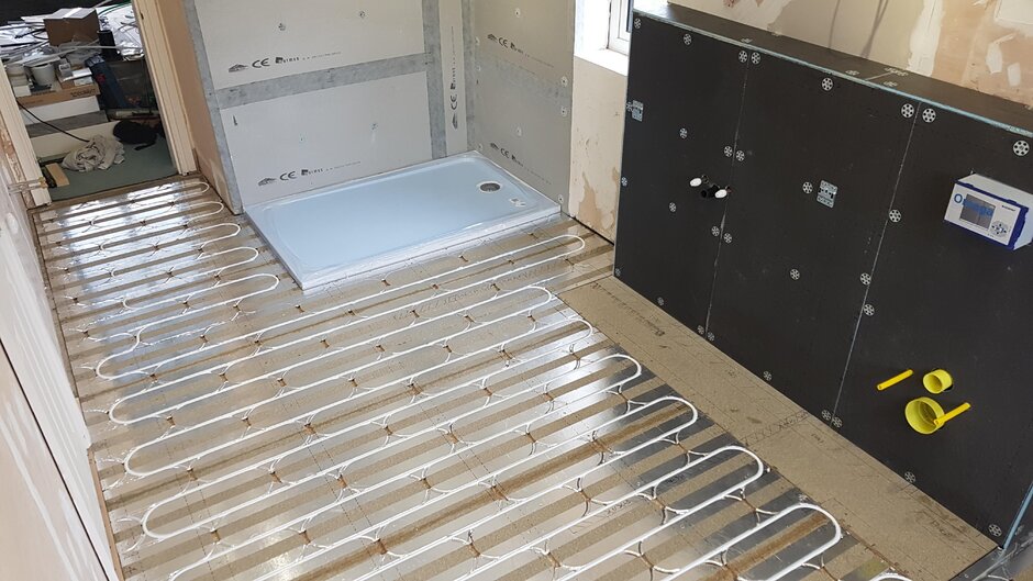

My Omnie TorFloor UFH is now in place and has been filled with water at mains pressure with no leaks, so after the pressure test tomorrow I'm ready to overlay the 22mm chipboard with 9mm ply, which will be glued and screwed.
I know fixing plyboard over UFH isn't a great idea but it is required as part of the Omnie specification to ensure the floor has the required structural integrity.
It occurred to me I haven't yet purchased any screws and was thinking of getting the Screw-Tite 2 PZ Double Self-Countersunk Screws 3.5 x 25mm or possibly the 4 x 25mm from Screwfix.
The combined floor thickness will be 31mm, so don't want to risk 30mm as these may push through the chipboard. 25mm seems safe.
Are there better screws or will these do the job?

I'm following the Omnie TorFloor tiling specification, which requires a minimum of 6mm ply screwed and glued to their 22mm routed TorFloor boards. The spec. has been approved/tested by Tilemaster and includes the following layers:
