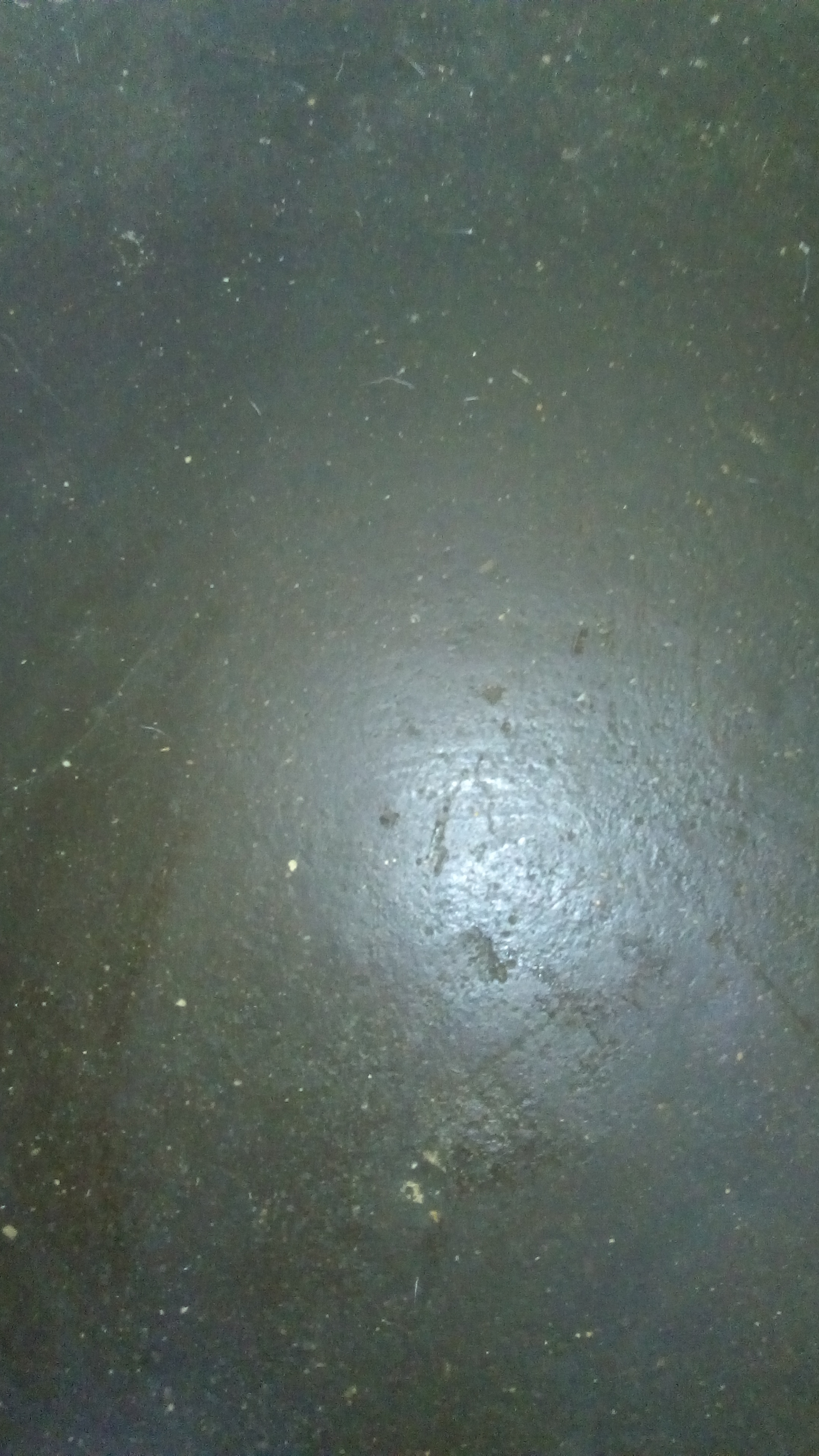

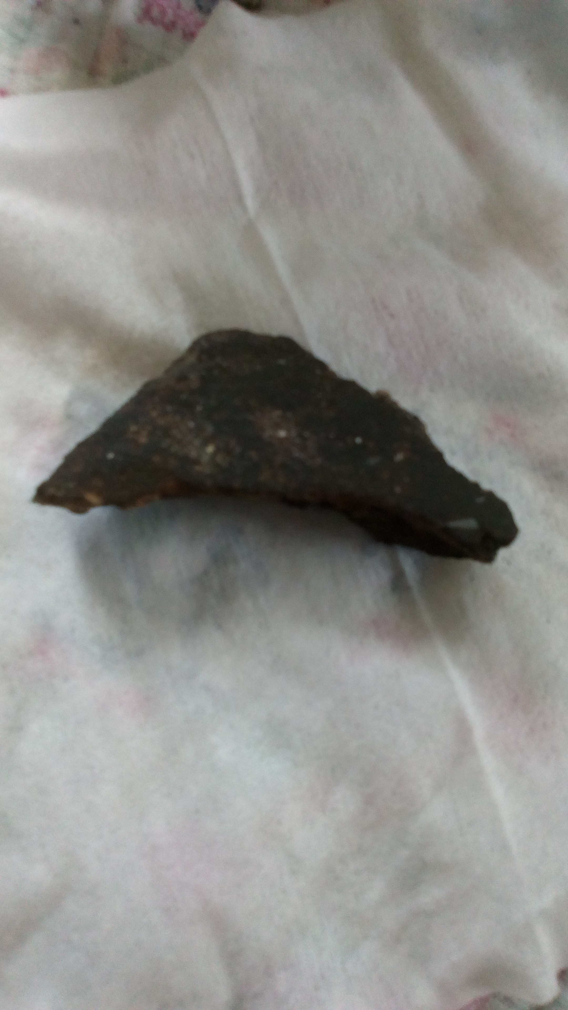

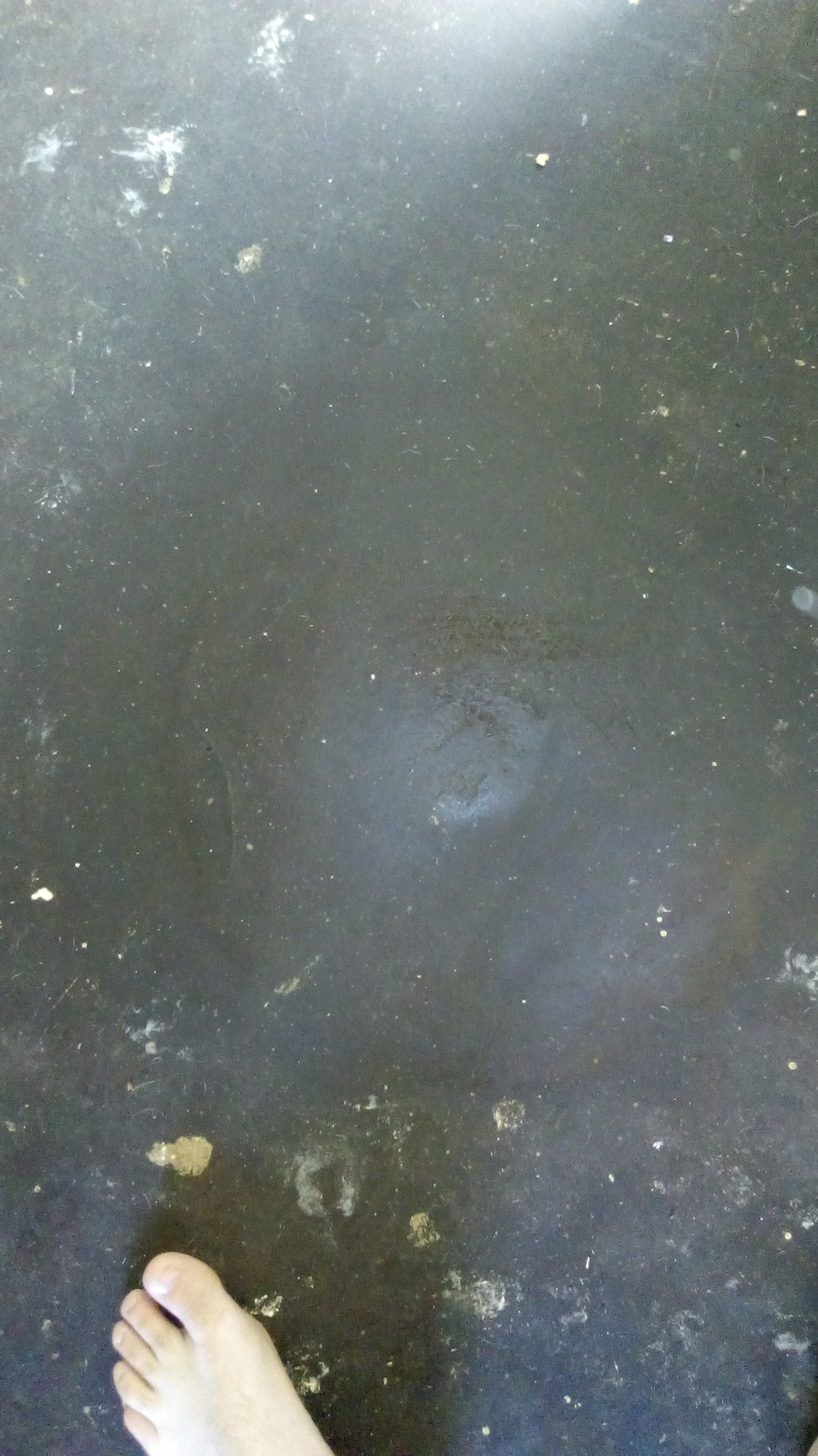

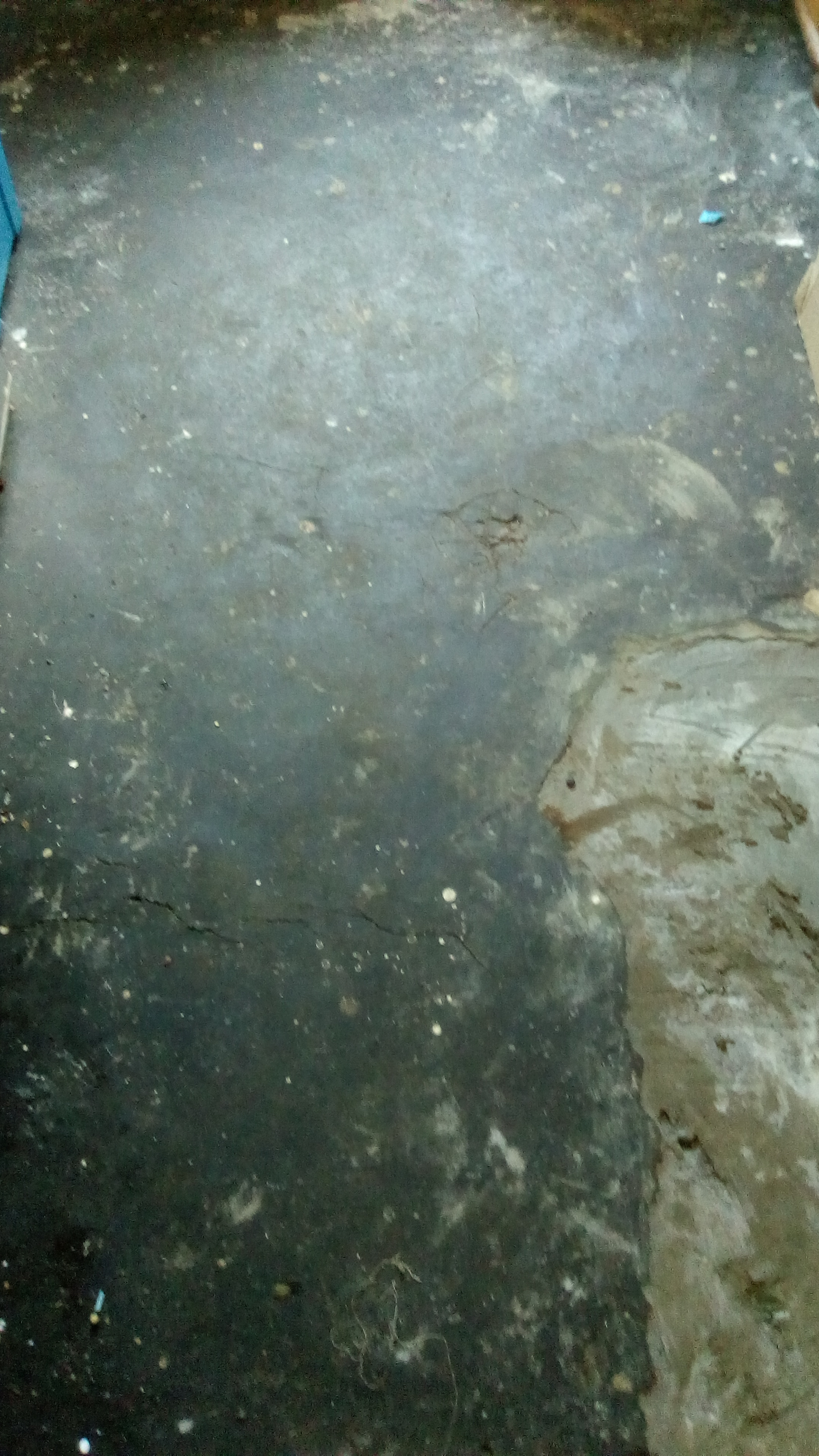

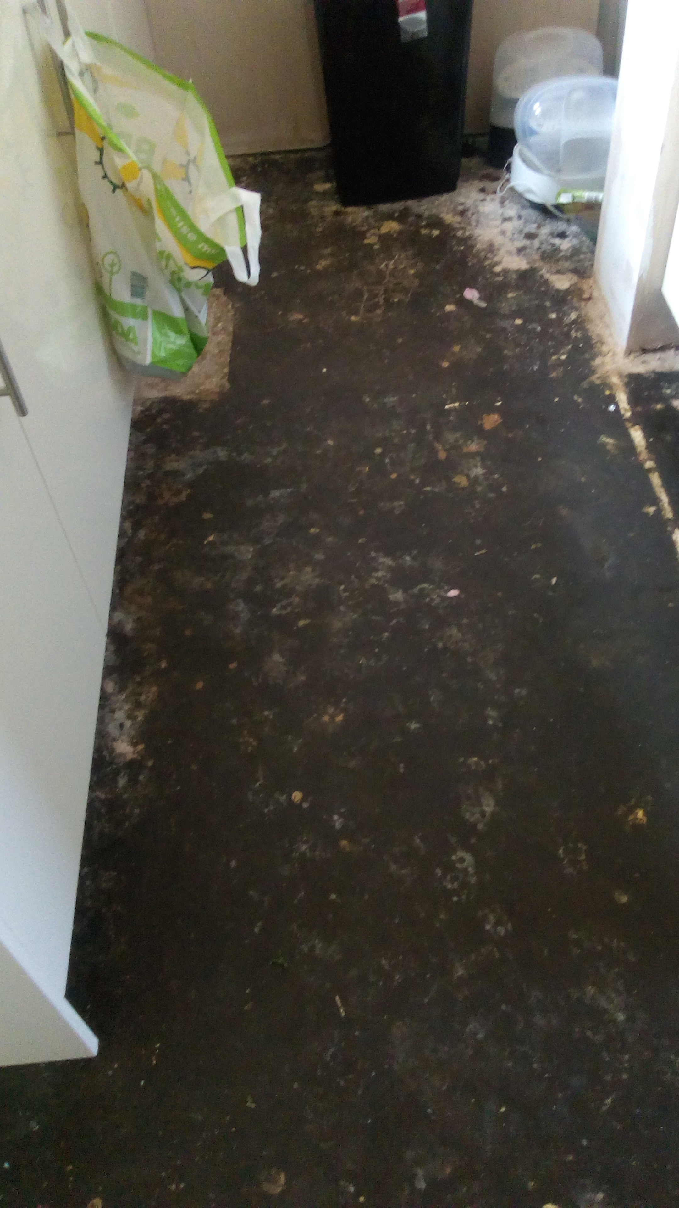

At 20mm built in the 50s be careful as it could be magnesite. These were often red, green or black and they will not take a tile adhesive or slurry. A quick easy test would be to use an electric damp meter like the ones used for testing rising damp. If its magnesite the moisture reading will be very high or off the scale
Is the colour of the floor black black(bitumin) or a deep burgundy (black pudding) colour?
I used to live in a 50's house, where the whole ground floor was supposedly levelled with a 20mm burgundy coloured coating, matt in colour.
That’s called ‘Magnasite’ and is a banned substance now.
It soaks up water like a sponge.
They also used to use all manner of fillers in the product.
The most dangerous of all was asbestos.
It should be removed before work commences.

Twice is better than none at all... at least that's what my Mrs says... magnesite was dreadful stuff though. Still an awful lot of it out there. It was mainly used in council houses....

try reading up on BAL FLEX BONE if the floor is flat and smooth just lay over and tile
That's a good point Ray. Would be interesting to see if they would recomend it over magnesite. Cant see why not...
