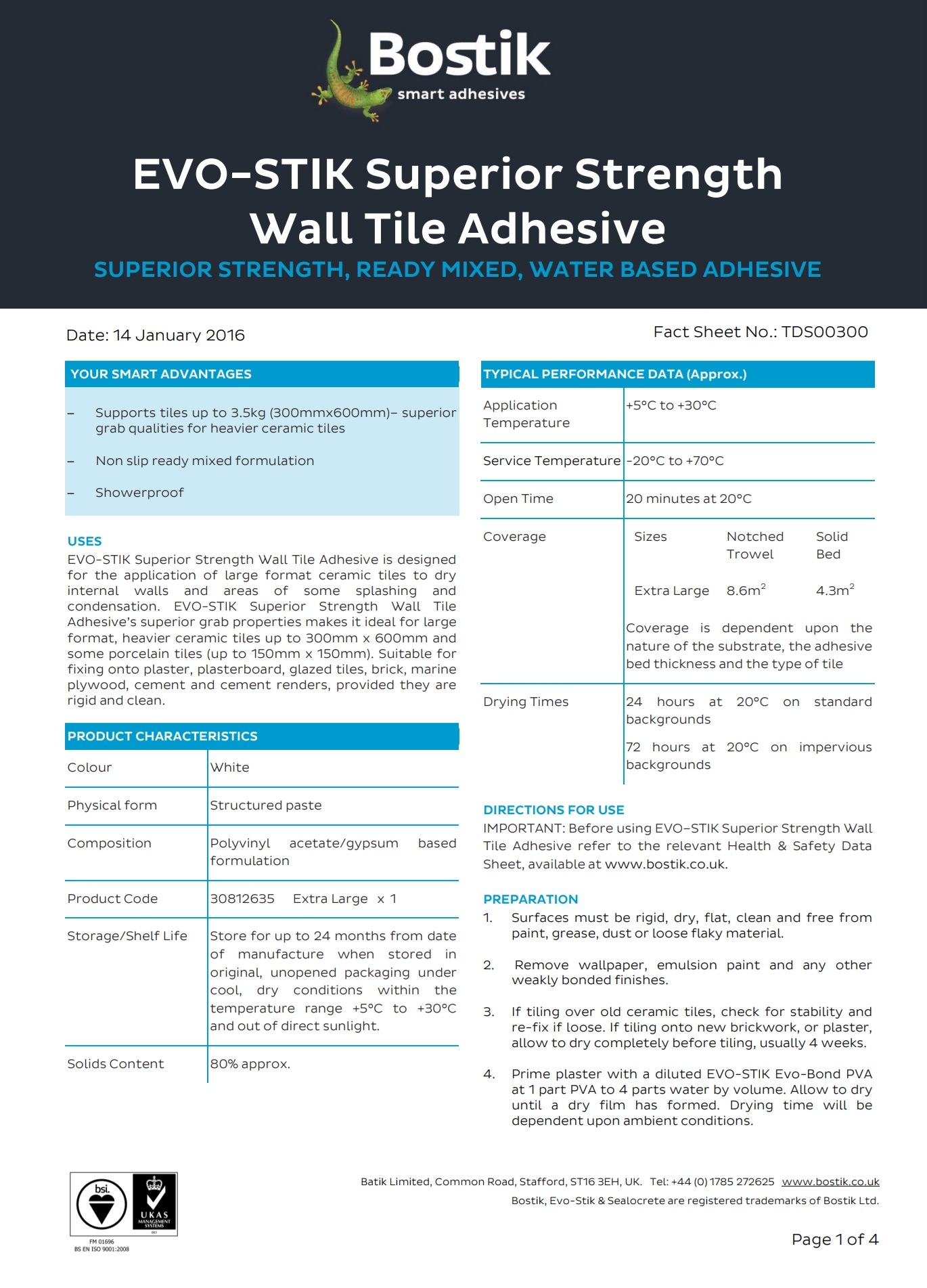

I already searched on the internet,however there are lots of mixed feedback, some say just pva,some say avoid pva, some say use what the tile adhesive suggests ( pva...) ,and than there are one person who has gone all over the internet and posted/Spammed in tons of places that how he is some kind of PRO and that he must give guarantees for his work so he uses some special kind of expensive primer (cough...snake oil promoter...cough..)
The tiles are heavy travertine+ marble in some places. was thinking about just keying the walls again and priming with a bit of pva or wallpaper adhesive.
