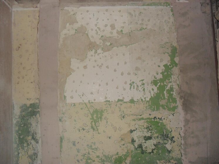

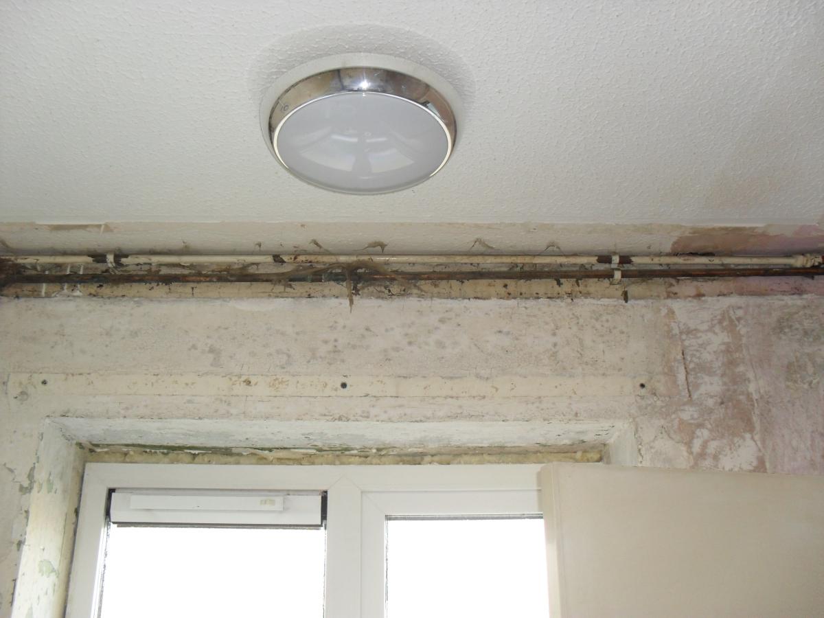

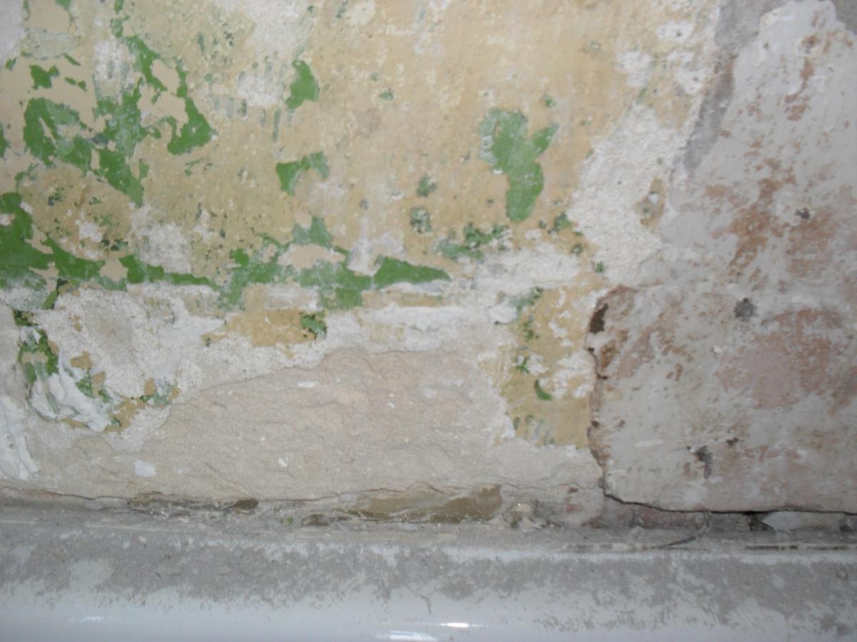

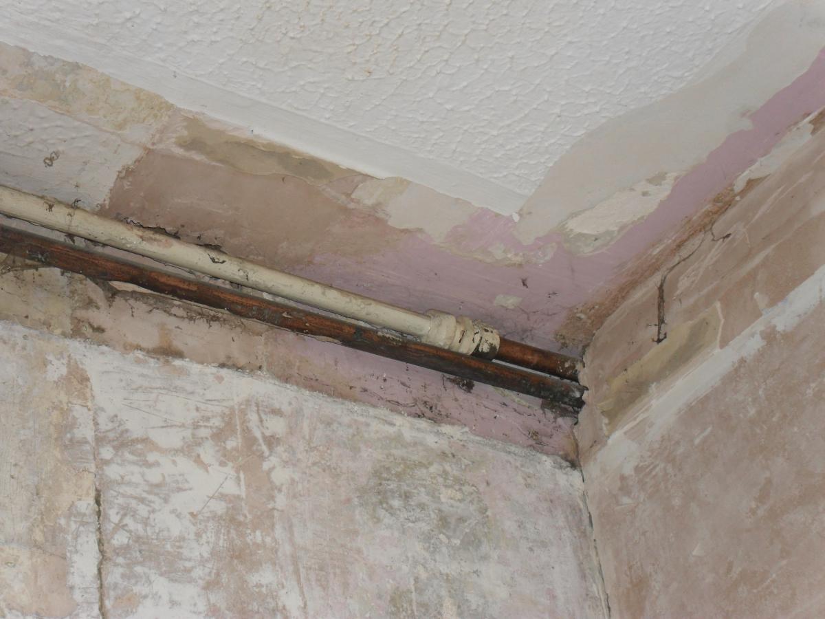

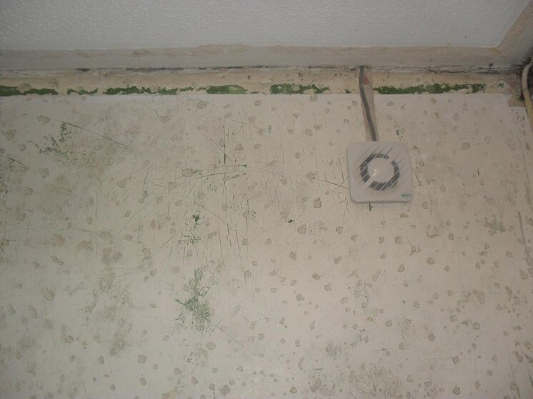

The first two pics are of the thermabloc wall and the other 3 are a good example of the other walls general condition,the large area to the right of the window frame in the fourth pic has been cut out to get rid of a 2cm render height difference where an original was removed,the thermabloc wall was put in its place to extend the bathroom.My main worry is that the walls have a slightly flaky enamel like paint over the horsehair plaster and it would be this coat the tiles have to stick to! i was going to just render up the cut out sections of wall (not yet done) sand the flaky paint to give key (done) and the little holes i made with a sharp point of a brickys hammer(to give grip for the adhesive) im not 100% that this would be good enough to hold the tiles,i thought of stripping right back to brick screwing thin batons to the brick say 600mm apart then working off the batons to render level,then remove batons render the holes left by the batons(no wood left to pop tiles) and tile directly onto mortar bed using cement based adhesive! would this be the right thing to do? is there a better way? is it overkill ie do you think if the wall cutouts were patched with render the wall may be sound enough,many thanks for taking the time to read my post and for any advice given.:thumbsup:

I would lower the ceiling mate, to the extent that it comes below the pipes.

The render on the thermolite blocks looks to strong for the block, normally they would have a lightweight gypsum plaster...which dos'nt stop cracking though..
The best thing is dry line the thermolites.
The ceiling need dropping as already said, could get someone to do a gypliner light weight metal system which would allow you to have down lighters if required..

Thanks for the replys :thumbsup:,some very good ideas i never thought of dry linining the thermabloc wall! forgot to mention that the nasty looking plumbing in question will be re routed into the floor space above (doh! sorry my fault) this plumbing was hidden by coving with a fillet piece underneath to extend the cove from the wall,if i lowered the ceiling i would still have the pipes running down the wall,in the 4th photo of the second lot of pics is where the pipes will run and will be the shower wall,the cold water feed comes first to the kitchen sink then runs behind cupboards up the wall and straight into coving in the kitchen then straight into the porch coving then bathroom coving (now took down) then the feed goes down to the bog along the bottom of the wall to sink...bath then combi boiler and the hot does exactly the same in the opposite direction from top to bottom..although not feeding the bog of course be funny if if did mind because id have a steaming hot toilet come bidet/*** cleaning receptacle :lol:.Whatever i do to the walls i reckon i will have to go back to the bare brick because the bathroom is only as wide as the bath!(another forgot to mention) and im really gonna struggle with the gap between the taps and the wall which at present with render is only 4.5cm from tap to wall! and thats with a 685mm bath...hardly room to swing a cat...the cat says thank for that.Can i screw/rawlplug plastboard onto the block will only using thin spacers to level the board? what tanking product would you advise? and would normal sand/cement render be ok to tile on? if i chose that route (because of the minimal width) thanks again to all,much appreciated! got the grey stuff going now:thumbsup:
