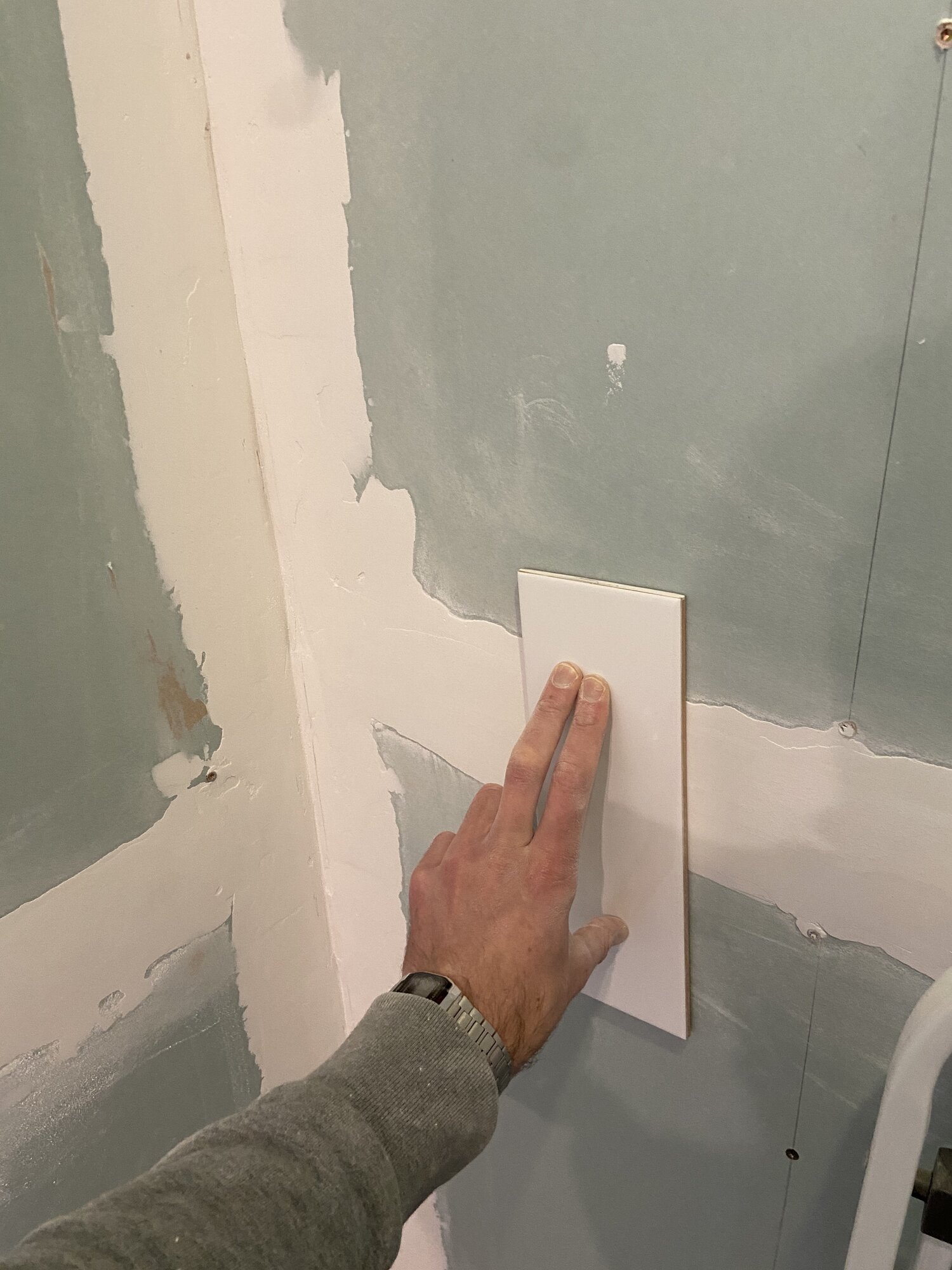

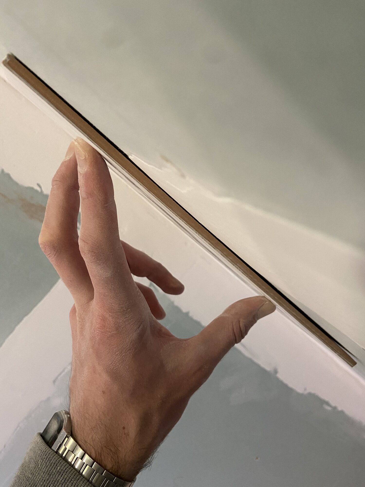

Just one other quick point. The joint compound is mostly smoothed, but some areas still have a slight bump to them. To sand more will get to the tape inside. Is this ever so slight gap ok? I.e. the tile adhesive will compensate and the tiles will still be flush?
(Placed a tile directly across horizontal PB join as an example, shadow makes it look a little worse. Point is it's not perfectly smooth)
