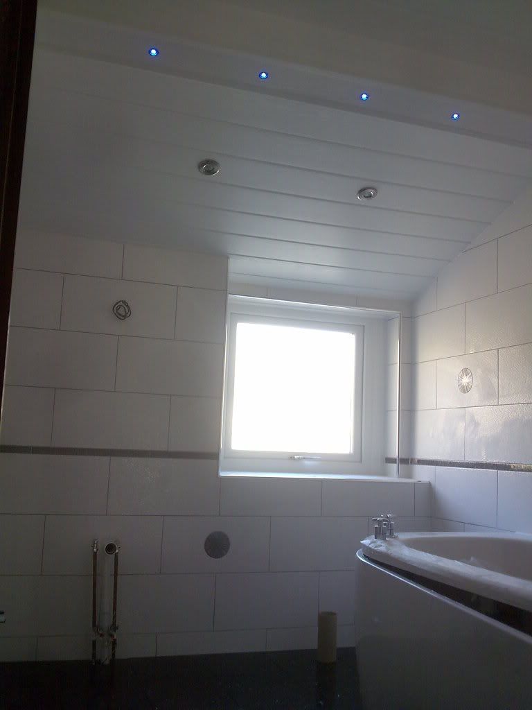

just a few ive done.
Hey Sean they look great!
I was thinking of putting lights in myself. I've already bought some outside deck lights I was going to use for below the bath and shower cubicle.
What lights do you use and where can you get them? Have you got a link?

the single light was one i had left over from my old kitchen and i fitted it for the lady as a free bee, the other ones i use are from a firm called robus.
Robus LED Decking Light Kit - Large Kits @ e-tradecounter.co.uk
i get them from a local electric wholesaler about £50 for the 10 light kit. about £30 for the 5 light kit.
