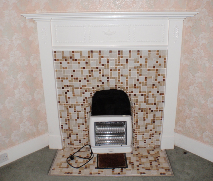

We have a 1920's tiled fireplace which at some point as been over-tiled with mosaics. We want to expose the originals which has some particularly nice curved glazed tiles, but are struggling to remove the mosaics, and have in a couple of places damaged the original tiles where the adhesive seems to have bonded very well.
So far we have been progressing with a filling knife and hammer trying to work under the tiles and break them off. The adhesive left behind can be scrapped off and cleans with some elbow grease, but I was wondering if there are any better tried and tested techniques for removing tiles or weakening tile adhesive.

Using a wall paper steamer has helped (not finished yet, but haven't done any lately!), but it takes a long time to get any moisture to penetrate through. My steamer provides about 1 hour of steam, in which time I can remove an area around 30cm x 30cm.
The key seems to be getting started and creating a route for steam to get in. I'm going to try scraping the grout out, as this means more moisture can get to a bigger proportion of the tile, hopefully making them easier to 'pop' off.
Below is a before shot - i'll take a picture this evening of where I have got to. Other than minor damage the tiles below are in great condition; we're happy to accept the odd crack and bit of missing glazed surface in exchange for the original tiles.
