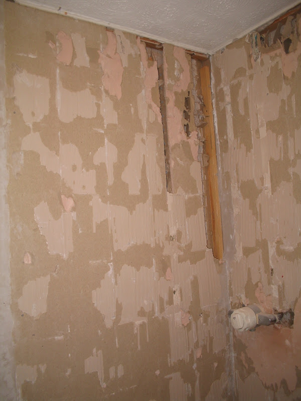

Thanks whitebeam. Its not water damage, it is damage caused when removing old tiles. Previously tiled area is 800x800mm shower cubicle. There are about 4 areas of damage, largest is 300x700mm in top corner, where it is almost completely destroyed; others are about half that size. I was hoping the panel adhesive would fix it adequately to 'far side' board, to avoid damaging tiles on other side.
Click here for a pic of the worst damage.
Personally I would square off where damage has accured, Cut out straight lines with a pad saw or stanley knife get some 12.5mm plasterboard cut to hole sizes Mix up some dri wall adhesive and dab some within the holes so it sits slightly proud of the existing surface and bed new cut board onto the addy and make sure it's flush with your existing boards. Hope this helps.
