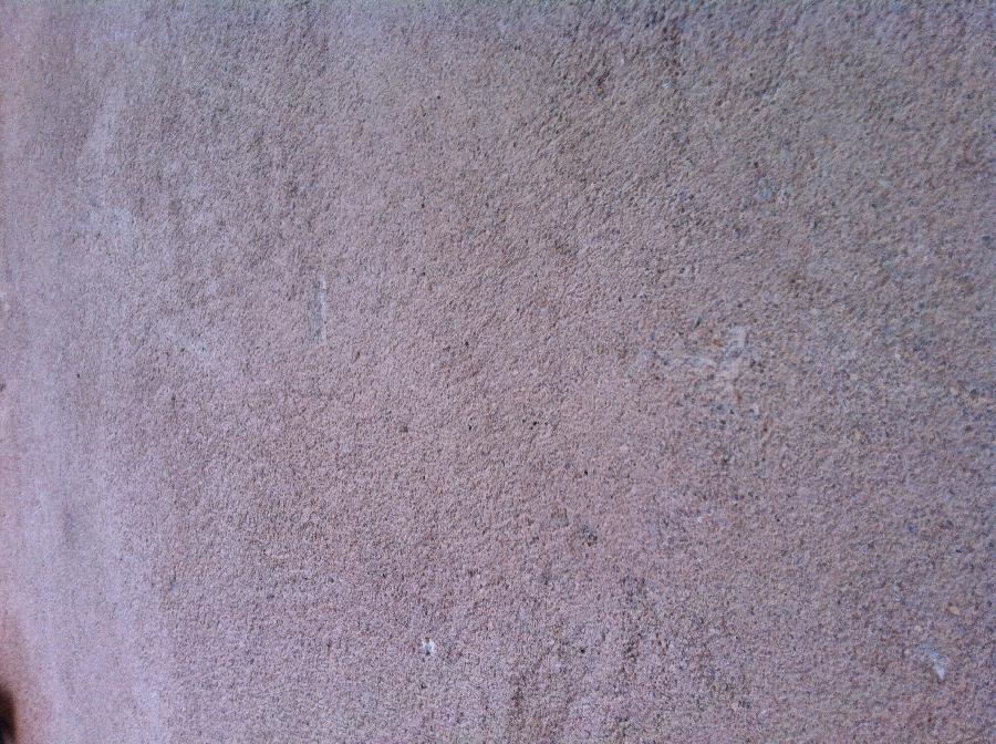

Thanks for the prompt replies, thats great. I posted this while at work, and now I am at home, I can see it is a sand and cement scratch coat, which doesn't surprise me as it was done in 1978 by the age of the house, and the tiles and bathroom were original to that!
The pinkish hue is from some remenants of finish plaster. What didn't pop off with the tiles I removed. It is a solid and true finish, perhaps a little grainy/dusty if you pull a tool along it hard.
A builder chap I work with said it was preferreable to pull the finish plaster off and go direct onto the sand and cement with a primer, and I didn't question this as a couple others had said to go this way too. It was only when I spoke to the girl in technical at BAL that I had jitters.
So, as it is sand and cement, and is firm, would you prime it? 2:1 BAL SBR?

Tiling on to the EXISTING finishing coat plaster is a no no. With the finishing plaster coming away when removing your tiles, this shows your plaster has blown. I'd use a 2:1 dilution of SBR. The girl from BAL probably thought what I thought. New plaster fully cured, yes. Blown plaster is no
