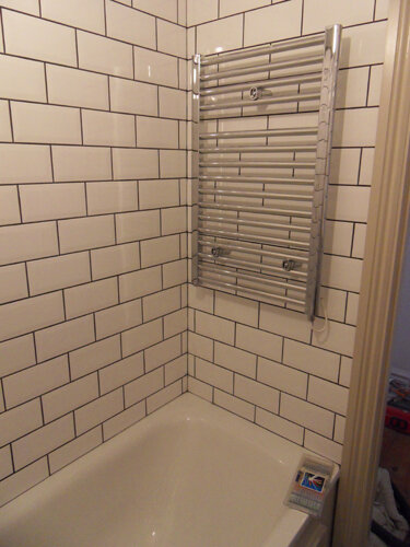

I prefer fischer cavity anchors myself over toggle bolts. If i'm using these then I insert them into the wall before tiling then place a precut tile over the top
This is a rad I did this week with them, three fixings are more than enough for the weight of this radiator
Thats the ones i was talking about, but as you say have to go in first!
If you use this type, invest in the 'gun' for squeezing' them if you rely on the screw to squeeze them the 'spikey' bits can drill through your plaster board
Plasplugs plasterboard plugs would be my choice this time round and as Paul said, clearance hole in the tile
