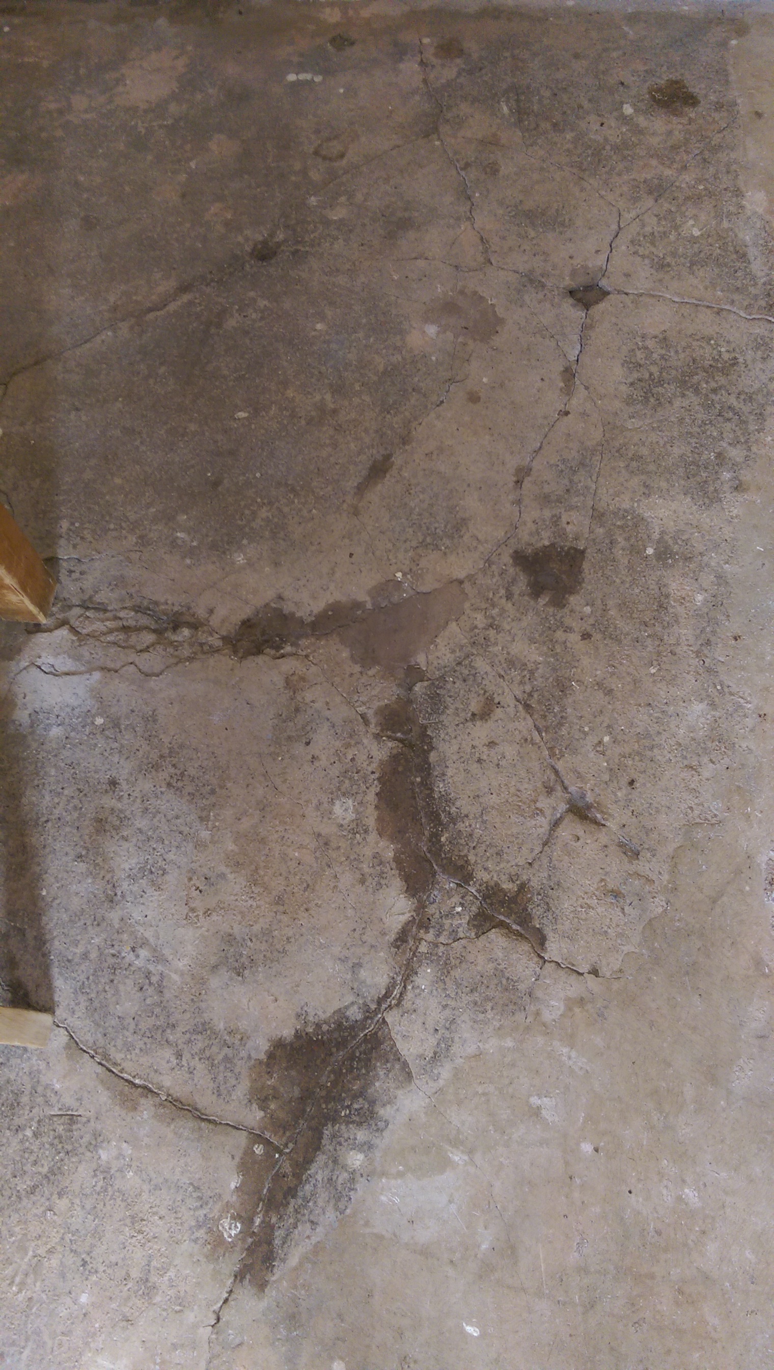

Looked that this floor this evening,the customer said the builders have used slc ,and it's cracking all over the place in the kitchen,she's bought 20sq in slate,problem is if I rip it all up and slc myself is it going to crack again,after I've tiled it
Just noticed the picture.
Is the dark near the cracks wet at all? Or has somebody tried to use a solution to stop it getting worse?
No wet this was done over Christmas,the floor is really bad a lot of bumps,I've said get the builder back so he can sort it out,but she said that's not happening.

Some Leveling compounds for tiling aren't meant to accept traffic on their own.
So it might be a case of it not being covered with tiles and being used and walked on.
Not all. I found that out the other week. Some are fine to have carpet on for example.

I'd not risk doing a little area and then tiling the lot once repaired. For the sake of a couple of bags more, just do the lot.
It might be something under it cracking and causing the SLC to crack. Until you get it up, there's no sure problem to deal with.
