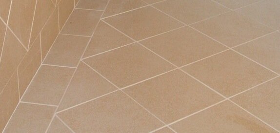

Unless you fancy laying them on the diagonal, with a border of about 20cm all around? It would make the hallway feel wider and you would end up with less cut to waste - although more actual cuts, of course!
I should have added this to illustrate. Imagine the right-hand side border and forget the wall tiling though! ;)
