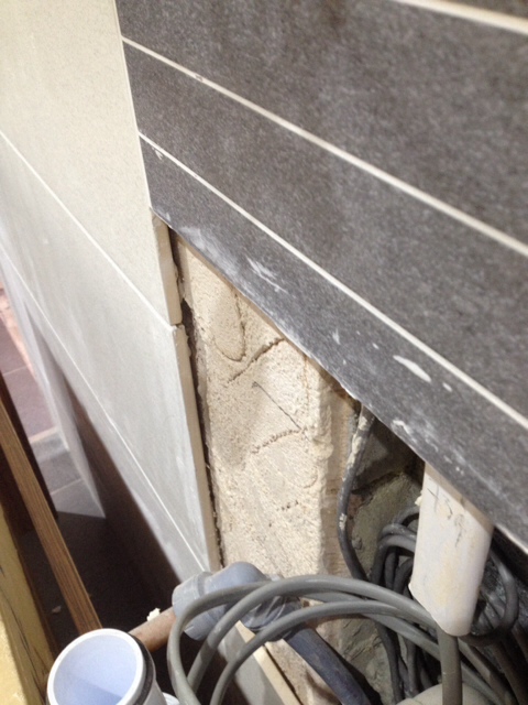

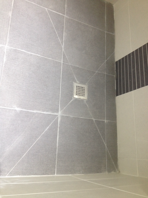

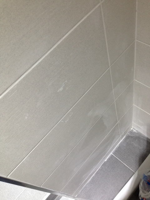

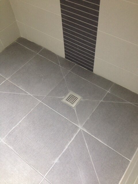

Called by a couple to inspect their recently installed wet room. A plumber who decided to turn his hand to wet rooms led to this mess-
ImageUploadedByTapatalk1382999887.964134.jpg ImageUploadedByTapatalk1382999904.158384.jpg ImageUploadedByTapatalk1382999919.818011.jpg ImageUploadedByTapatalk1382999934.839787.jpg ImageUploadedByTapatalk1382999947.053621.jpg ImageUploadedByTapatalk1382999958.161268.jpg ImageUploadedByTapatalk1382999971.854395.jpg ImageUploadedByTapatalk1382999981.792728.jpg ImageUploadedByTapatalk1382999991.746854.jpg ImageUploadedByTapatalk1383000002.578116.jpg
Nothing good to say about the work! Lippage, messy grouting, uneven levels, bad cuts, no tanking (still wrapped up in spare room) spot fixing, poor layout plus my favourite......UFH sensor cable that he was planning on taping on top of the tiles!!!!
Returning in the new year with any luck to rip it all out and start afresh :)
